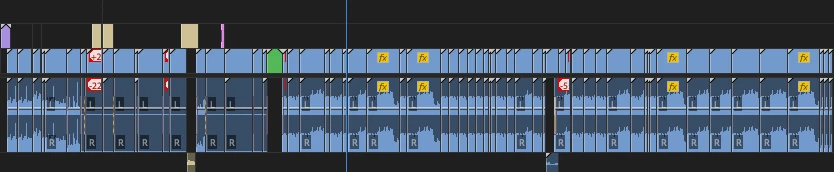

Alright I've been having trouble even describing what exactly it is that I'm experiencing. It's happened on two different computers and it's absolutely devastating. Lets say I have an hour long clip of raw footage. I take the footage and I pull various selections from it, from the preview panel into the timeline. Your standard, run of the mill editing workflow.
After a few days of editing I have a nicely assembled timeline with dozens or hundreds of cuts. and then it happens: premiere pro crashes, and I reopen the project only to find the in-point for every cut has been reset to the beginning of the original raw clip. Now my meticulously curated edit has turned into a variable-length loops of the first few seconds (or frames) of the clip. Over and over and over again. So I hit undue a bunch. Doesn't help. I go into the program panel and offline the raw clip, and reconnect it to the original. No difference. Instead of reconnecting the clip, I choose to "replace it" with itself (or with a duplicate of the original raw clip).
I quit premiere, go into the autosaves and pull up the last stable build before it crashed, but somehow, the in-and-out point error has perpetuated through all of the autosaves, down to the earliest version of the edit. WHAT IS GOING ON???
This is the third time I've experienced this apocalyptic error. the first two times I swallowed my sorrows, deleted the entire timeline and started again from scratch. This time I have just watched a week of editing vanish before my eyes. I can't take it anymore!
look at this nonsense, every clip is the in-point of the raw:
