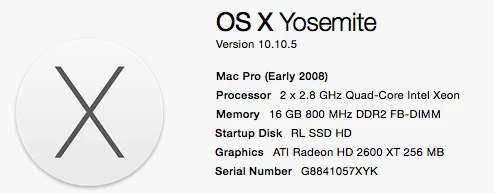

AGR_Chris
May 10, 2017
We have the same problem as Anthony03238. This requires an URGENT fix. We always use the latest version of MAC Premiere Pro on MAC OS 10.10.5. We have been struggling with this issue for sometime now.
