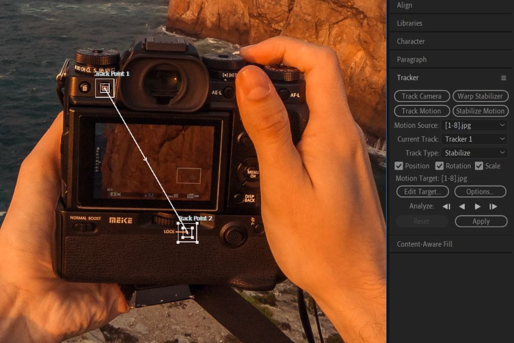

is there an option to stabilize the footage with 3 tracking points?
Thing is, I would like to create something like stop-motion video from photos of some object.
So basically I want to choose 3 points on that object on all photos and then make software to align it.
Is there any way how to do it? I know only about 2 points stabilizing.
Thank you for any help.

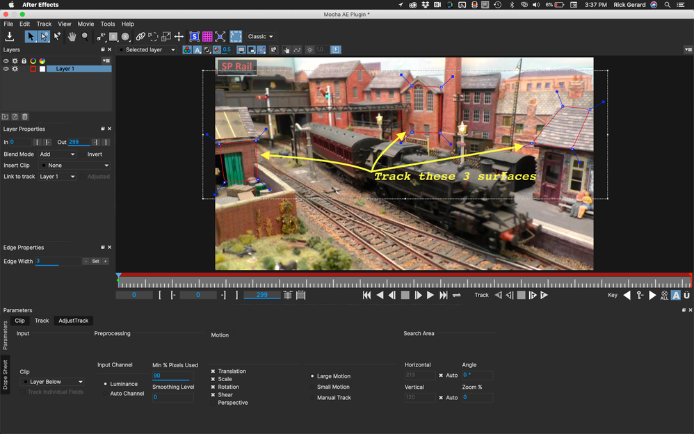

All tracking in After Effects uses a feature region and an attach point. You can track as many individual features (the inside square) as you like and attach as many reference layers or nulls as you like. You can also track surfaces in Mocha Pro.
Stop motion photography requires you to have prominent nonmoving features lined up or to use carefully planned camera moves and then manipulate the objects in the scene that you want to move. I'm not sure how Motion Tracking is going to work unless you have some surfaces that you want to lock in place to fix some poor camera work.
It would really help if we saw that scene you were working on. I'm imagining a model railroad set with three surfaces you could track.
If you track all of these objects on a single layer in Mocha AE and then use the transform instead of corner pin the 3 objects will stray lined up, but if the camera is moving then the parallax between other objects in the scene is going to change and look very odd.
Show us your scene and we can give you a much better idea of how to handle the post-production problem you are running into.
New Here ,
Mar 16, 2020 Mar 16, 2020
Thank you for the reply. I have several photos like this from different locations and I would like to align the shots with the camera. I did it one time, you can check the video here - https://www.instagram.com/p/BwpcOa_AQLP/ but I was just wondering if there is a way to simplify this process. I made this in photoshop and it's not very accurate.

No, no ... I didn't want to make all the work by software. I just wanted to go pic by pic and manually choose 3 same points on camera. For example, some buttons and then make the software to align those points.
On this pic, you can see how I tried to stabilize it, but there is still some wiggling, which 3rd point maybe can fix.
LEGEND ,
Mar 17, 2020 Mar 17, 2020
The wiggling is most defintely not from the tracking, it's from the minute variations in the perspective. Fixing this semi-automatically would require some advanced 3D tracking, local unwarping and possibly even projection mapping. You can of course try eyeballing it in AE by aligning 3D layers that are massaged with distortion effects, but a real academically and mathematically "correct" alignment can't be achieved that way. That would still require mocha Pro, Nuke, SynthEyes or similar tools.
Mylenium
New Here ,
Yes, I know it's from changing the perspective. Thank for advice, I will try it.
