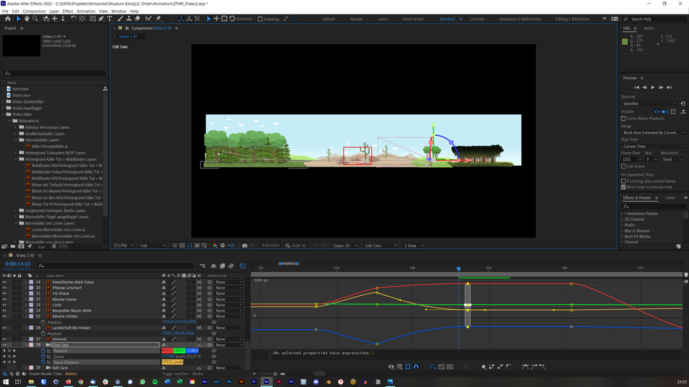

Firstly I'd like to thank you a lot for your suggestions and explanation. Unfortunately I still have the same problem.
Yes you are right, the video is in 4K and I am nearly exclusively working with illustrator files. I keep continous rasterizing off usually while editing, otherwise my PC would get too slow for me to really be able to work properly. I thoght I had the camera set up with 35mm, although it seems now to be at 128,91mm. I tried and changed it to 35mm but after adjusting the view with moving the camera nearer to my object I ran into the same problem. Aperture is set at 500 pixels. In my previous video I had a fairly similar setup but with the layers way more apart from each other, mostly 500 pixels between. Same problem. That's why I chose less space between the layers in this projects hoping to fix this. The object from the screenshot above is so far from center of the composition because my composition is pretty wide, I have different scenes in this background to which I fly the camera (see the new screenshot attached).
I think I might have narrowed it down to what might the exact problem, but I still don't have a solution.
As you can see in the other screenshot even though the keyframe for the camera movement and the focus distance are exactly on the same frame and I only eased them simutanously with F9 their values don't go perfectly together on the last frames leading to the one with the next keyframe. If I switch all of the keyframe's interpolation to linear the problem is gone, but as you may think, the movement looks weird and stops abrupt. Do you know if there is a way to ease just exactly alike, so the focus distance is right?
Fixing the focus distance to a certain object or a null object is not really a possibility I think because my camera needs to focus thoughout the video on different objects with different  postions on the Z-axis.
What do you think?
