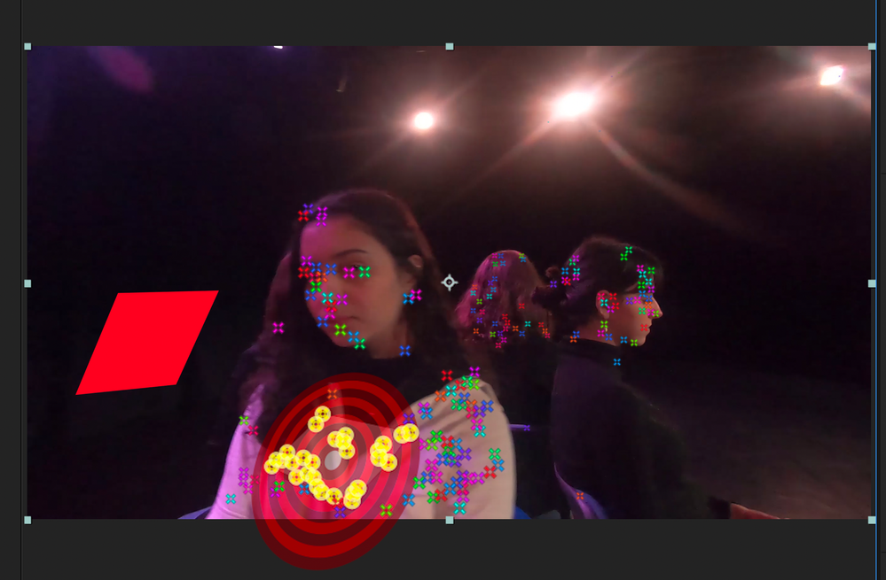

Advanced Analysis did give me a camera solution but there were a bunch of errors and I couldn't get any targets that really looked like they were going to align to any surface. You'll have to try and delete as many tracking points as you can on things that are moving like this actor's face:
Try that several times and you may find something that will give you a decent surface and a camera solution that actually works. After deleting a bunch of points I added a camera and a solid, added a grid to the solid to help me visualize the surfaces and then added a couple more. Things started to look promising. Here's the workflow in a couple of steps:
This was the best looking and biggest surface that I used to start. Then I added a couple more surfaces (solids with grids):
I'm getting closer. Some of the points just didn't produce the results I expected.
After a little more work, removing some more points on surfaces that moved (faces) I came up with this. You are looking at 2 views, top and Active Camera, and several reference solids placed so I have some kind of a chance at getting a Ground Plane (the floor) in the scene and placing 3D elements in the shot so they move correctly. You should be able to right-click on the last image here and open it in a new window or tab to get a good look.
I spent about an hour fiddling with the shot and got pretty close. I have a lot of experience with camera tracking and I knew immediately which track points needed to go. I deleted trackers about 4 times and let it solve for the camera again before I added the camera and some reference solids. Then I had to delete the camera and all the reference solids and try again twice to get this far. The track is never going to be perfect and getting the 3D layers to stick to the real geometry in the scene is going to be difficult because there is so little fixed geometry in the scene to use to make the calculations. I don't know any 3D camera tracking solution that would give you a really good track of this shot without a bunch of manipulation and a good deal of experience. You might be able to get something that will kind of work for a class, but I'd never use this shot for a paying client. I'd reshoot.

However, after tweaking the lighting, and throwing the footage to a noise reduction plugin (Neat Video), I did manage to get quite a decent track on the first try. Check the attached movie ...
Thinking about the scene, you really only need to have an origin point and a stable rotating camera.
The middle of the scene is inbetween the backs of the characters, so I found a frame where all their shoulders were visible, and selected as many track points as possible until the tracking target marker looked like it was horizontal and in the middle. That's where I set my ground plane and origin. Then I just checked some markers on the faces of the characters to have a text or plane follow their movement (not necessary, but just wanted to check the movement).
Cleaning up your original footage is key. Once you get the center ground plane and origin set, the rest is quite ok.
