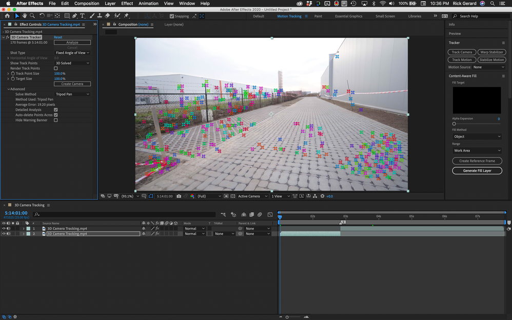

That is the shot I have seen before. It's a terrible shot for camera tracking. If you are on the first frame and you set Show Track Points to 2D Source and you set Track Point Size to 300% you should see something like this (note - I am using the Motion Tracking workspace):
If the Track Point Size is set to 100% the points are so small they are hard to see. Change Show Track Points to 3D solved and you won't see any track points at all, even though the Average Error is only 1.54 pixels. You can't see the points because the shot can't be solved for the first few frames. Most of the time you will get an error message telling you that the camera cannot be solved.
If you move down the timeline about 3 seconds some tracking markers start showing up and you should be able to grab a few and set an origin and ground plane, then add a camera and a solid on this frame. You should also set a layer marker so you know where the origin and ground plane is at 0, 0, 0.
So I set the origin and ground plane, then add a camera and a solid using the same points and same target. Remember how I said the origin and ground plane should be at 0, 0, 0. Look at what you get:
This tells me that the camera solve is no good. I suspected that because the first two or three seconds of the shot is a crazy terrible Tripod Pan. Only after about 3 seconds does the shot turn into something that can possibly ave some depth information. Scrubbing through the shot confirms that the solid will not stick to the ground.
From the marker forward the solid sticks pretty well.
You have two options here. Split the layer at the marker and treat the first about few seconds as a camera pan and the second as a normal track, or just ignore the first few seconds. Here's what that looks like. The first part of the shot as a tripod pan:
The second part of the shot analyzed again and a new marker set, a new Origin and Ground Plane set, and a reference solid and a camera added. Note the position property of the reference solid is at 0, 0, 0. That's the first indication of a good camera solution.
Screenshot_2020-09-22 22.41.05_XJJSdR.pngScreenshot_2020-09-22 22.42.34_3DaJ8X.png
The solid is not going to line up with the first part of the shot, and you'll need to add a camera and a solid to the first part of the shot, but there will be no depth information. Maybe if you overlapped a frame you could somehow line up a second solid with the Tripod Pan camera so you could cut between the shots, but it's not likely that it will be easy to do or completely seamless.
Unless the tutorial that goes with this footage explains why the shot won't work for normal camera tracking or at least asks you why it won't and where camera tracking works, and unless this tutorial talks about setting an origin and ground plane and explains that the reference solid is at 0, 0, 0 (use a solid so you can see if it tracks to the surface), I would give the tutorial an F, delete it from your bookmarks, and look for a camera tracking tutorial prepared by somebody that knows what they are doing. Unfortunately, most of the tutorials you find using Google are prepared by enthusiasts that have discovered some kind of a recipe that kind of works with their specific shot. They are poorly explained and often the workflows are incredibly inefficient. This shot would confuse anyone that does not have a good understanding of the proper camera tracking workflow.
I'm saving a copy of this thread so I can point others to the solution. This is at least the third time that I have helped folks figure out how to track this same shot. It would help if you could post a link to the tutorial so I can give it a proper review.

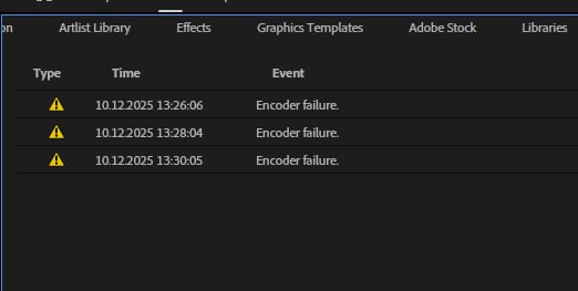

I had this issue a couple of times in the latest Premiere Pro (alongside with rejecting to render in place an AE comp with tracking inside Premiere, saying there's a renderer error), except that there were NO tracking points at all (I changed their size). Having worked half a year in Davinci Resolve with its marvellous tracking, which tracks always, everything, with no exceptions or preparations what so ever, I really think Adobe should reshape AE tracking. You have too many "conditions" working with it. A proper media resolution, a proper framerate, ignoring the bettering of the picture to HELP the tracker do the job better, constant precomps. This is really lame in 2025, nearly 2026. The tracker should track ANY media and give at least some tracking data - not an error - so the user can do something with it.
