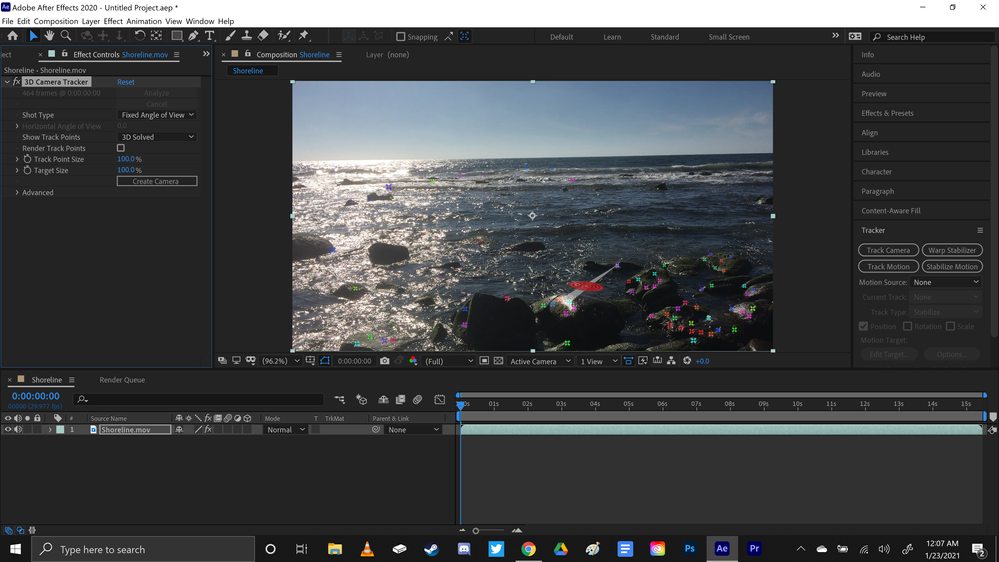

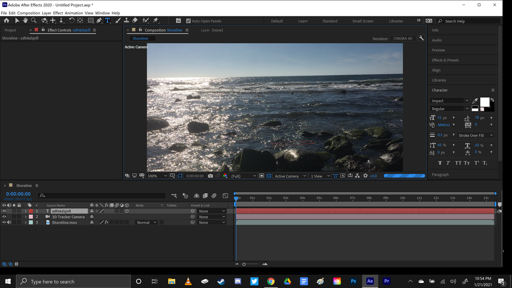

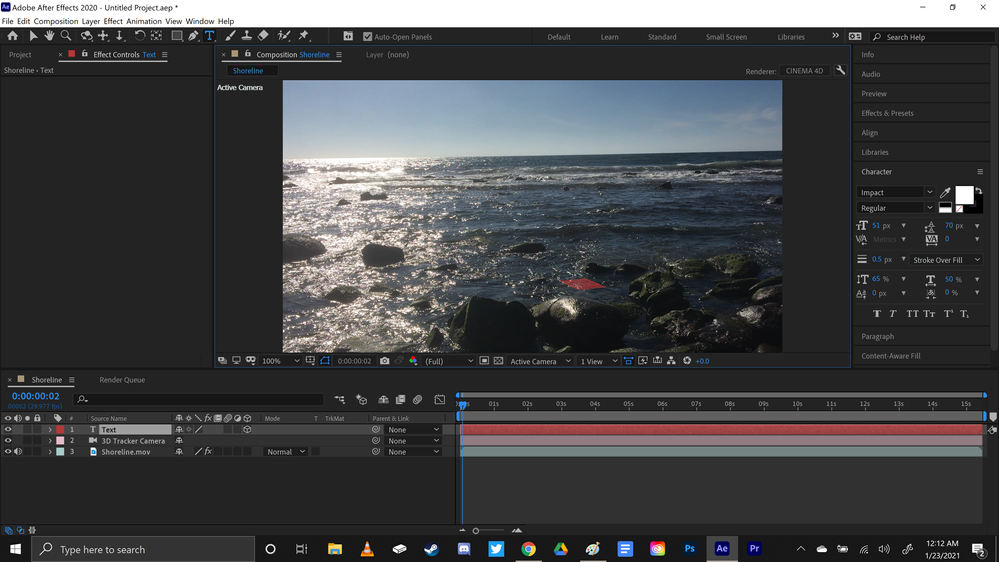

It's not a text layer that I added though. I'm having difficulty with the text inside 3d camera tracker's text maker. I show my process below. The text is not appearing...1.png2.png3.png4.png5.png

OK I FIGURED IT OUT!!
So after discovering that my laptop can't run CINEMA 4D after attempting a lesson involving it, I've been experiencing 3D Camera Tracker issues ever since...and now I know why my text won't appear in the 3D Camera Tracker text box! It was so simple! All I had to do was revert the Renderer options from CINEMA 4D back to Classic 3D in the Composition Settings!
