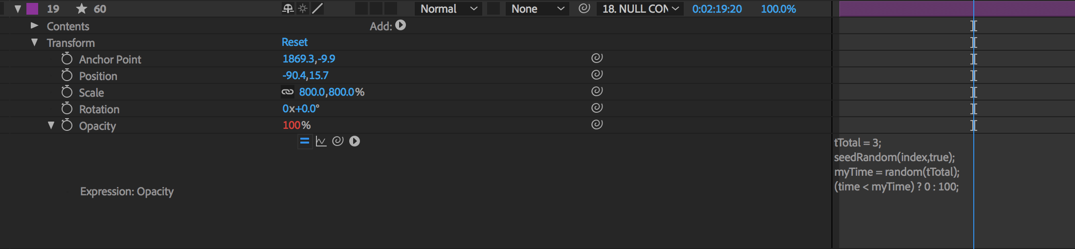

Copied
Hi
Thanks again for the explanation. I have added the above expression to my opacity property of the overall shape layer (60, see screenshot). This results in the full 60 shape with all it's underlying smaller shapes suddenly appearing at a random time.
Any ideas what I'm doing wrong?
Thanks
Juliet
Copy link to clipboard
Copied
What happens is exactly what should be, if you apply this expression to the global opacity, as you did.

Copied
You'd have to apply the expression to the opacity of each shape, not the overall layer.
