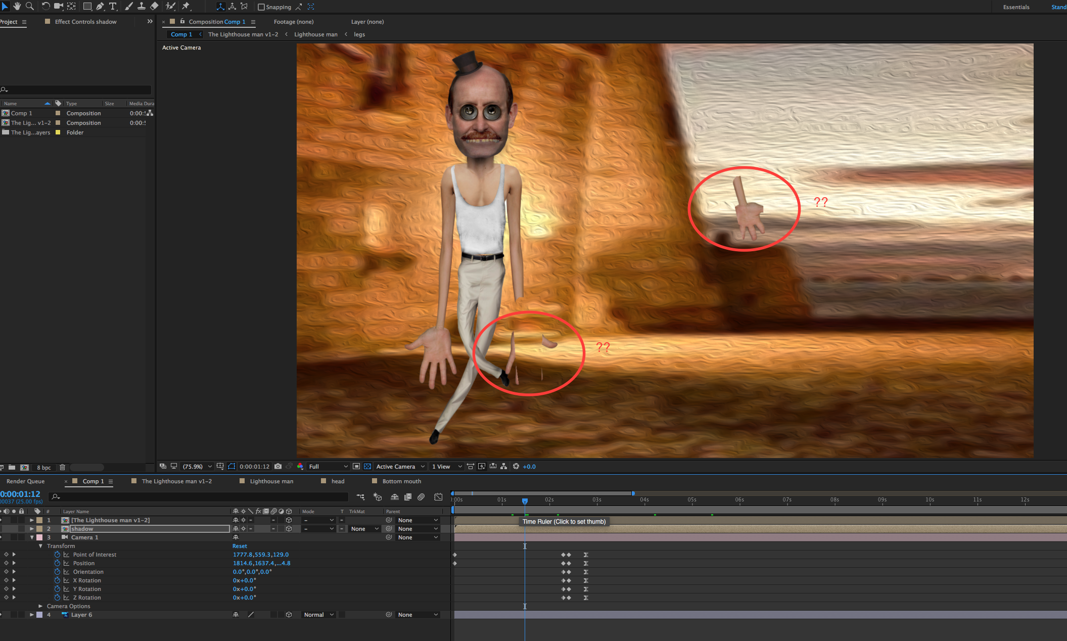

H there,
As the title suggests I have animations nested within 2 and 3 compositions deep in my project which all play within their own compositions (I have however experienced a few issues where some of the puppet tool animations would jump to a position I haven't told them to on playback), but when I come back out to the main composition there is no movement at all.
Also when I animate from the main composition I'm getting some strange masking issues, however I haven't added any masking (Reference image attached).AE CC 17 issue.png

Looks like you have collapse transformations enabled on something animated with the puppet tool. These two features can conflict with each other. Try turning off collapse transforms and see what happens.
Community Beginner ,
Nov 06, 2016 Nov 06, 2016
That seems to have solved the problem in this instance. However after many years using After Effects in this way it's the first time I've encountered this issue. Do you know if it'll be resolved moving forward?

this issue is a result of the render order pipeline which was always there in Ae and probably will be forever. puppet is an effect and effects are applied before transformations, unless you click the collapse switch and it reverses the order. therefore you should not change or animate transformations for a collapsed layer or precomp when using the puppet effect. this is from the help files:
Animating with Puppet tools in After Effects
Note:
Don’t animate the position or scale of a continuously rasterized layer with layer transformations if you are also animating the layer with the Puppet tools. The render order for continuously rasterized layers—such as shape layers and text layers—is different from the render order for raster layers. You can precompose the shape layer and use the Puppet tools on the precomposition layer, or you can use the Puppet tools to transform the shapes within the layer. (See Render order and collapsing transformations and Continuously rasterize a layer containing vector graphics.)
