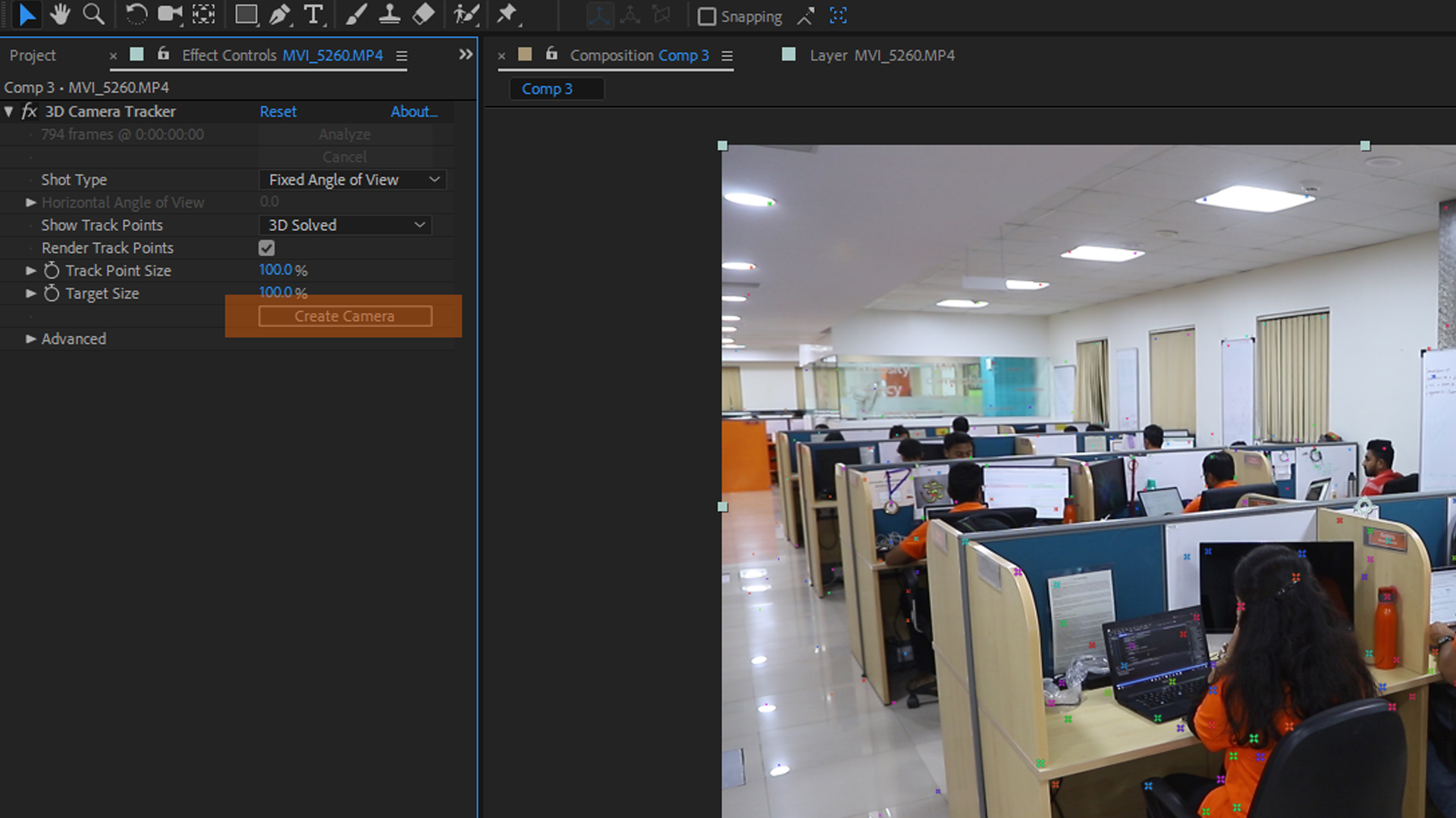

First u need to click on create Camera (highlighted-orange).
After the first step, you will get a camera layer on the timeline, and there you go!
Select any track point you wish to select.
I hope that's helpful!
