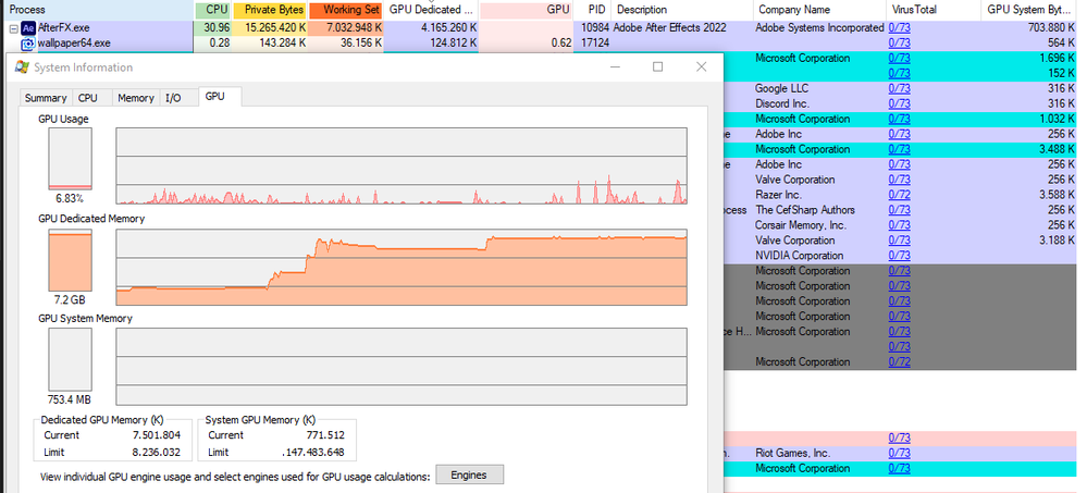

Hey,
so After Effects is not performing very well on my PC. Sometimes its so bad that my PC Frezzes and i have to power reset it. I ran some checks and the Problem is that when After Effects is open my VRAM Usage Jumps from 300 mb in use to 7,8 GB in use. I check and it looks like After Effects is using almost all of my VRAM on my GPU. That causes the System to Frezze.
PC Specs
CPU : Ryzen 7 2700x
AIO : Corsair iCUE H150i ELITE CAPELLIX 360MM
GPU : RTX 3070 Gaming OC
RAM : Corsair Vengeance RGB Pro 16 GB 3200MHz
Here are to Screenshots of the Problem
Without After Effts
I dont know why After Effects does that and it only happens when i render the Project with my GPU, the second problem it that it doesnt even peform good. When i render with the Software encoder its smoother then with my GPU. Sometimes even effects dont render with my GPU and i had a problem with a Project where i coudnt render it using my GPU because it Media encoder either failed or got stuck at a Frame.
Thanks for reading this and for any Help

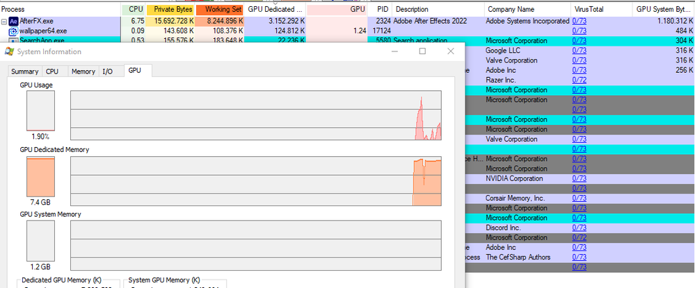

Here is a screenshot with Multi Frame Rendering disabled
The Video Content is on a Samsung 870 QVO 4TB SSD, I use Flow,Twitch, Sapphire and CONTINUUM as Plugins with alot of Position and Scale Keyframes.
,Olivier
