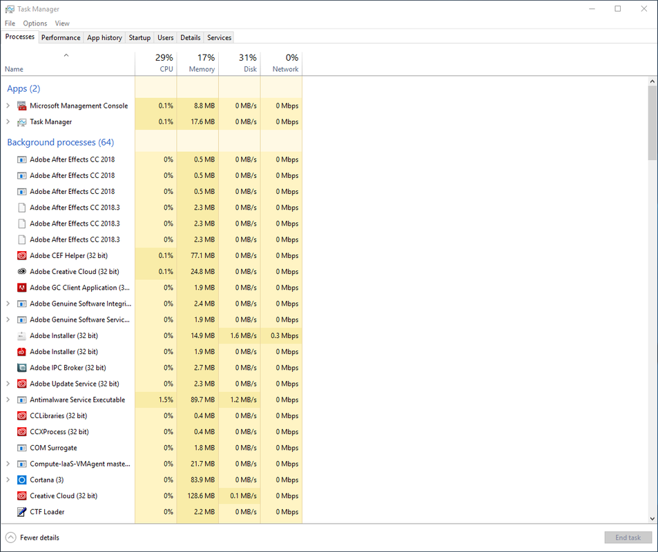

And this 3 times, in 3 separated cmds. You can check taskmanager to see if there are 3 aerender.exe running and 3 AfterFX.COM (if I remember correctly).
It looks like you are starting the same instance 3 times instead of starting 3 instances at the same time.

The problem is only if i try to run multiple instances in the background.When I run the script, I opened the task manager and all three instances show up:
