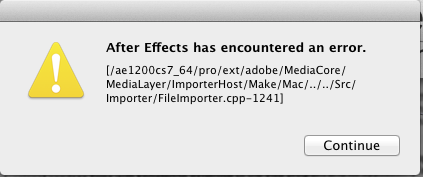

I would like to add my situation to the list.
I have a Mac Pro running Mac OS X 10.7.5 and Adobe AE CC, I have an AJA Kona 3 card and a Quadro FX 4800
I have updated all AJA Drivers to the latest available. And removed the AJA Adobe Plugin from After Effects (I didnt like that it didnt upscale lower res previews to fit the screen)
I deleted the DVCProHDVideoOut component and that didn't fix the problem. I then removed  all AJA components and reinstalled the Pro Codecs, and one of those actions seems to have fixed the issue, I haven't had time to put components back in to the Quicktime folder yet to pinpoint exactly which component might be the culprit but based on the blog post I suppose its the AJA Output component. I was also getting a slightly different error message when I was crashing in addition to the "moov" error, which I have attached below.
