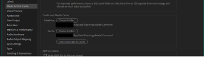

Adobe Employee , Jan 22, 2024 Jan 22, 2024
Try clearing the Conformed Media Cache, see the image below from preferences on where to do that.
When AE attempts to read a video/audio file, it will store a separate file in the media cache that helps speed up file loading. My guess is that a matching conform file is being found and then that's being used and is causing the issues you are seeing.

Didn't work.
Also noticed After Effects sometimes makes a "..._AME" folder next to the project file. I honestly don't know what that folder is but I deleted it and tried again but still got the errors.
Did get a slighty different error message while trying out your suggestion and other things. Still the same error code though.

  • Preferences > Media & Disk Cache > Clean Database & Cache - the pinned solution at the time of writing - does not fix this particular problem. This button doesn't seem to make any changes to the Media Cache Files folder at all. It may clear other caches, but they seem to have no bearing on this issue.
