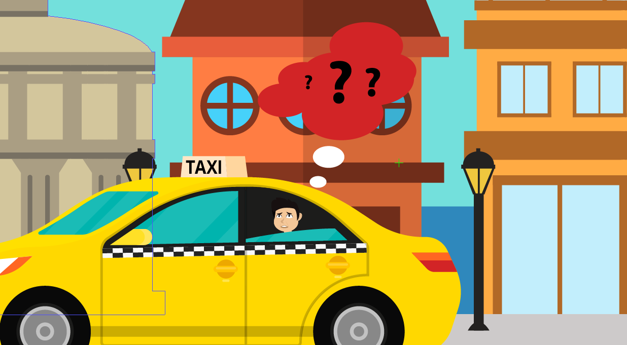

Thanks for your assistance. I am having the same issue with completely vector (.ai) layers. Whenever I resize or zoom it in, It gets pixelated or blur and this is happening with the render also. I have also attached the vector file. Further the artboard size in illustrator is same as the comp size in after effects.456.PNG
Please suggest suitable solution.
Many Thanks

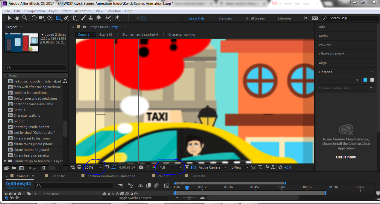

I found this post while trying to solve the same issue. The answers given above no doubt helped things a bit, but I later found a perfect solution. I'll mention it here for anyone else who wanders by!
In the composition there is a star icon. It toggles whether rasterizing is continuous or not. Clicking that cell to enable the option completely fixes vector assets:
Ha! Edit: Although the thing that solved it for me wasn't mentioned in any of the answers, it was stated as part of the title! So, if you haven't tried the continuous rasterize, do try it, even if it didn't work as well for the poster of this topic.
