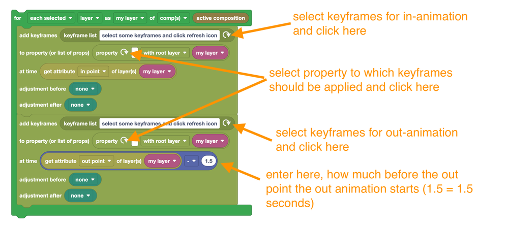

I created the attached sample Automation Blocks tool for you. Before you can use it, you need to load your own custom keyframes into the script as described here:
The cool thing about this approach is that you can apply any kinds of keyframes with arbitrary easing etc. All you need is a sample layer, which contains the keyframes you want and then you load them into the script as described in the image.
Once this is done, you can use the script to apply the same keyframes to all selected layers an
Once this is done, you can use the script to apply the same keyframes to all selected layers and it will adjust to their in/out points automatically.

And if you want to create keyframes on multipe properties at once (say animate both position and scale), you can simply duplicate the "add keyframes" blocks.

Ooooh, man! This is amazing!
Just tested it and it's quite very easy to modify and use. It's nice to know too that it can copy ease information and that the keyframes are save across projects.
It is quite a challenge to me sometimes to understand what does what and how to find it, but you make it look a lot easier with this kind of things.

A cool thing about this approach is also that the keyframes.(with all their easing, timing etc) are saved as part of the script. So you can create a collection of tools to save your favorite keyframes. Like
- one tool for a basic scale in/out
- one tool for an overshooting scale in/out.
- one tool for an opacity fade in/out combined with a subtle rotation
... whatever you want.
