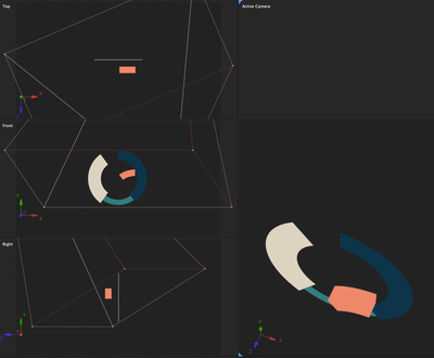

I've changed the position of the red item by a positive value for both x and y coordinates, and by a negative value for the z coordinate.
As you can tell from the red-green-blue xyz reference system, After Effects incorrectly displaces the red object in both y and z directions. It looks like the y axis is pointing downwards and the z axis inward.
This reference system is in opposition to what is drawn on screen.
Therefore one or the other needs to be fixed, if I'm interpreting this correctly.

The top view camera  (which you have on the top screen) is looking down on the scene. This is how AE normally behaves. If I'm understanding your question correctly, this isn't a bug and is normal behavior.

Do you see the red-green-blue xyz 3D axis?

I'm looking at the reference system in the left corner. I don't think that has anything to do with axis mode. I believe it's the “Active Camera” reference system, but no one is confirming or disputing my claim.

There seems to be some confusing regarding my question. Here is a more accurate explanation.
Can anyone explain to me what these 3D axis represent, since they are clearly wrong?
Explorer ,
Feb 28, 2021 Feb 28, 2021
Ah, I see. These xzy triple is the camera reference system, and not the global reference system.

Can someone please confirm or dispute my understanding here?
Namely, what does the reference system in the bottom left corner represent?
Are these the camera / view coordinates?

Please, read my question once again.
I have even drawn a diagram so you can understand what I'm asking.
I believe the axis represents the Active Camera reference system.
Now, how does one reset its view?
