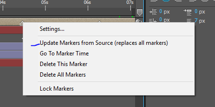

Call "Update Markers from Source".
Engaged ,
Aug 15, 2016 Aug 15, 2016
Is there a way to call "Update Markers from Source" command from a script?

David, thank you for the advice. I've been using this technique to create comp markers, thanks to one of your videos. For some reason ID=2539 doesn't seem to work. Calling
alert(app.findMenuCommandId("Update Markers from Source (replaces all markers)"));
shows 2539, so the ID is correct. Also, I'm making sure that the right layer is selected. Any idea what I'm missing?

The menu commands get called from the app level, since it is app.executeCommand(). Since you have to access that contextual menu by right clicking an actual Marker, and not just selecting a layer, this may fall into the "unstable" category. Markers don't have a selection attribute unfortunately, so I'm not sure it will be possible to get this particular command to properly work.
