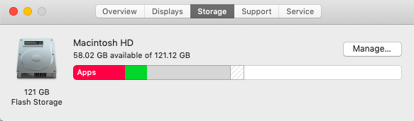

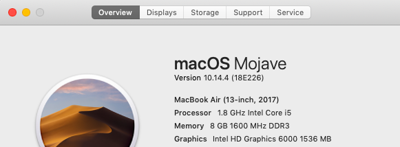

I created a 7sec clip in After Effects, but I'm completely new with the program, so all the files in the composition are different sizes. Don't know if that's one of the reasons I can't save the clip as a video. I'm using Macbook Air with this info and 120GB Storage Space.Screenshot 2019-04-05 11.52.15.png
This is how my storage is

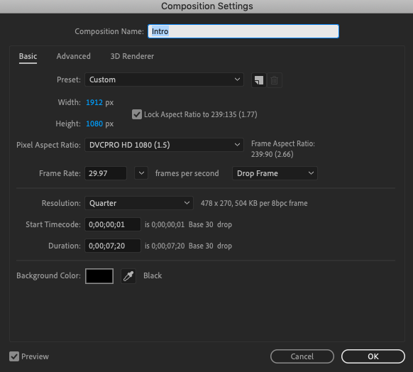

and these are the Composition settings

If you are very new to AE you should not be creating custom composition sizes. Use the presets. Your composition should be 1920 x 1080.  You have also set the pixel aspect ratio to 1.5 and that will screw everything up. Guaranteed.
The media encoder may have given you a low resolution copy because the composition resolution is set to 1/4.
The failure could be caused by a plug-in or a bunch of other things. Without complete workflow details or screenshots with modified properties of the layers it’s pretty hard to tell what’s going on. All we can see in the screenshot of your comp is that you have a bunch of layers, you have a frame size that does not comply with any video standard, and the composition resolution is set to 1/4. The failure in the render cue could be simply a matter of trying to render a non-standard frame size.

Ohhh I just realized I made it custom by accident  ‍:female_sign: I had originally chosen HDTV 1080 29.97 but for some reason changed 1920x1080 to 1912x1080. I also made the resolution composition 1/4, because that's the only way it would play in Preview. I think I'm going to just restart the project with the right dimensions and smaller images

You can change the comp size just in the running project but it will mess you all your position animations slightly - so you have to re-check them.
Smaller image sizes can be a solution, since your computer has very little RAM and huge images requires a lot of RAM. However, if the preview only renders in 1/4, you are lost. If it is not rendering in full res (regardless the time it needs to do it), you need a better computer to do the job and finding one for free is a question of luck.

First, your computer is - roughly said - useless when it comes to AE. To weak, to less, no matter what.

Is there a special reason for the missing 8px in comp-width? Standard HD is 1920x080px.

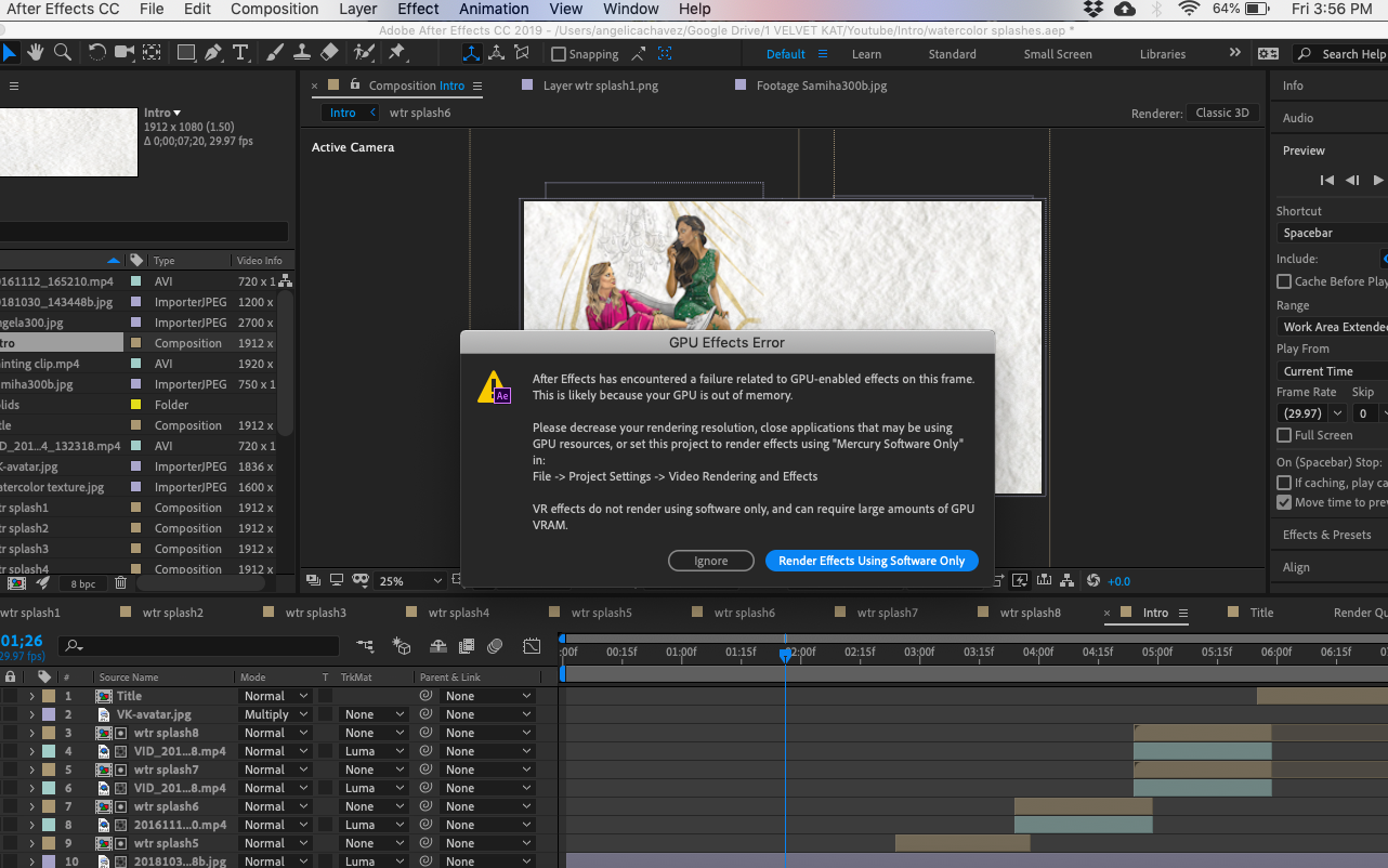

I did get this error when making the composition full rather than 1/4
But like my reply to Rick says above, I'm going to start over with the correct dimensions and such. You're right that I learned, I just didn't want to start over lol but it's wasted me more time breaking my head over trying to fix an already messed up file instead of starting over, since I have an idea of what I'm doing now

Thanks for the error message!
GPU is out of RAM and cannot calculate the effect. You can go to file > project settings and disable GPU support as a first try.
Which effects are you using around 1:26?
