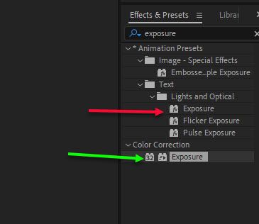

And the effect is at about thw 12:00 minute mark. As you can see in the screenshot attached, you can apply several effects (linear wipe, then two fast box blurs, then add a solid composite)... but when you try to add an exposure effect, as the tutorial states, it does not show in the comp window so you can adjust settings. For reference, in my screenshot, you should see about 4 exposure effects, as I attemped to drag the effect in multiple times.
I'll attempt to restart AE, and then of course my laptop to see if this resolves...but I'm thinking if I'm having the same issue, on what appears to be the same tutorial, something must be amiss..

Nevermind my previous reply ....I found the issue. Danette, make sure you are choosing the right "Exposure". You want the green one in my sample below not the red. The confusion happens because the guy who made the tutorial uses that plug in of his, rather than the actual effects pane....so he chooses the first one that comes up, which is what I did and I imagine what you did as well.

Thanks! I was trying to add the Lights and Optical exposure so many times but then I saw this post and scrolled down a bit further and saw the color correction exposure.

The first displayed Exposure you see in the Search Results, in the Effects & Presets Panel, is an Animation Preset. Animation Presets have the "fx" text/label indicator. Effects are either 16 or 32 bit and this delineation is displayed accordingly, next to the effect's name. HTH
