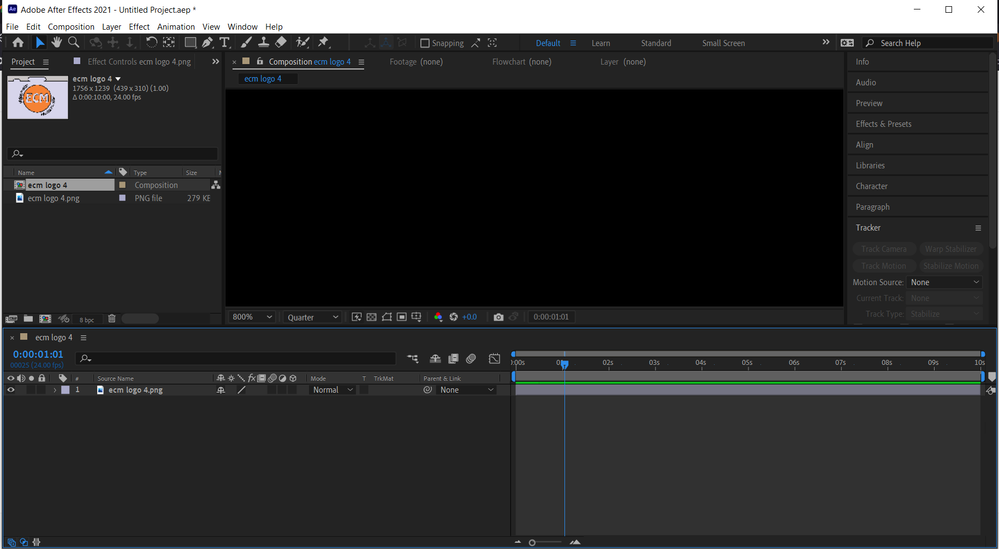

Nuevo aquí ,
Feb 05, 2021 Feb 05, 2021
Hi Vishu
I am facing this issue in a few of the projects I download from the store. Please help as soon as possible. I am pretty close to the deadline.
Traducir
Informe
Directrices de la comunidad
Sé amable y respetuoso, muestra títulos de crédito de la fuente de contenido original y busca duplicados antes de publicar. Más información
Nuevo aquí ,
My UI
I checked opacity
Turned off all the effects.
Deleted cache and disk from preference.
Deleted from Purge.
No Caps Lock ON.
Did everything but nothing worked
