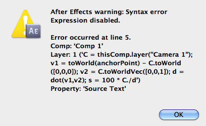

Perhaps I'm using this wrong, but I'm applying your expression to a text layer source and I'm getting a syntax error:
Jul 27, 2011 Jul 27, 2011
That's strange--I don't know how that happened. I'll try it again:
