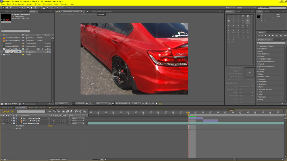

So, here's the original image with the corruption:
Original Image to be InpaintedOriginal Image to be Inpainted
It is in the bottom-right corner.

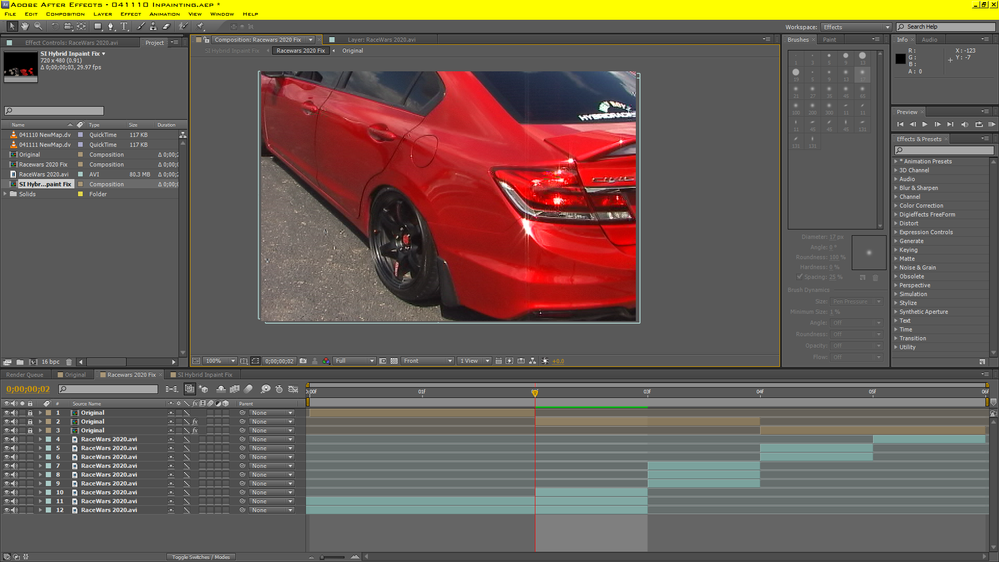

So first I removed the corrupted blocks:
Corrupted Blocks RemovedCorrupted Blocks Removed
Then I used the preceding and succeeding frames (with masks) to "paint" the missing parts of the image:
The painting mask, shown without the original good data.The painting mask, shown without the original good data.
Here's what the final product looks like:
Final Inpainted ImageFinal Inpainted Image
Looks good from a distance. But that checkerboarding pattern you see by the wheel of the car? When I put the newly inpainted blocks into the original video file with a hex editor, more of that appears, because the DV overflow scheme is different on the saved file. I need AE to save my file using the original file's overflow scheme.
