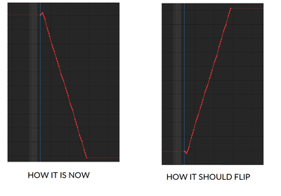

I wonder is it possible. I have an animation of an object that moves down on X axis. I want to flip the values so they move exactly the same but upwards starting from the same value. See attachment.

That looks like a screenshot of the graph editor with separated dimensions. The movement of the layer is originally right, then left, then right again. I don't know what the vertical movement looks like.
You can flip the graph upside down and change the X movement so that the movement starts where it now ends and ends where it originally started by selecting all keyframes and then choosing Animation/Keyframe Assistant/Time Reverse Keyframes. The problem with separated dimensions is that you will completely change the actual path of the layer by only reversing the X position keyframes. You may want to turn off separate dimensions. Changing the motion path in a predictable way gets a lot more complicated when you separate dimensions. You lose Bezier handles in the Comp panel, and modifying a curved path becomes almost impossible.

Correct, I work on separated values. I only change x value. But I don't want to reverse the keyframes. Now the object moves to the left side of the comp (so the x values decrease). And  I want the object to start exactly at the same x value but move to the right side of the comp (so the x values increase). I want the corresponding values to stay at the same distances but to go the other way. Sorry for my english, I'm trying my best 🙂

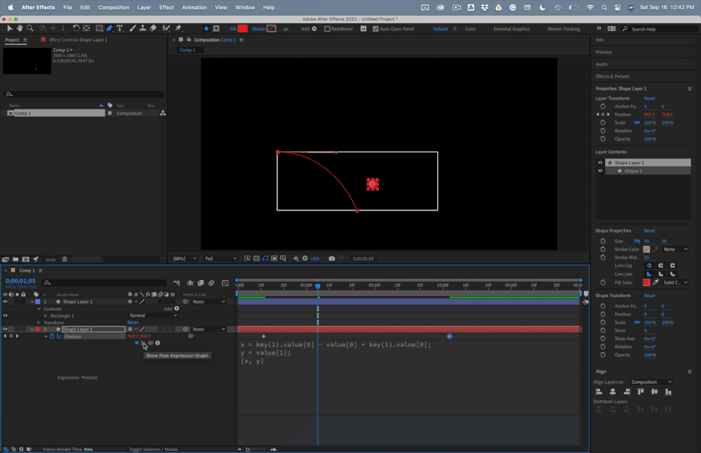

You have a bunch of keyframes, so the easiest way to reverse the direction of the movement from the first keyframe to the last keyframe would be to add this simple expression:
mov = key(1).value - value + key(1).value
or Dan's expression. Both will work.
You could also modify the expression to work with an array so that only the X value reversed direction with you don't separate values.
x = key(1).value[0] - value[0] + key(1).value[0];
y = value[1];
[x, y]
That would give you the option of modifying the original motion path in the Comp panel like this;
