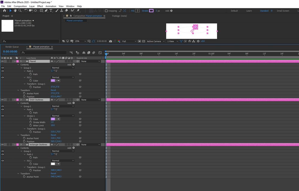

I am using After Effects 2020.
So I wanna make a planet move around its orbit. Googled some youtube videos, But I can’t achieve the same effect.
I copied the path of orbit, and then pasted it on planet’s position property. Instead of rotating the planet it kept pasted in a different place!
Why?  What am doing wrong?
Even I tried ctrl+shift+v , it makes the black!

I do not see any 'Path' there. what I see is.
Orbit> Contens> Group1> Path 1>Stroke 1> Transform: Group 1.
And If I click path1 then I get 'path'. You mean this path?
Anyway why it is a group?
and Thank you so much for teaching me what that ctrl+shift+v does! usually It works as paste in place, so I tried that 🙂

Jun 19, 2022 Jun 19, 2022
If your rectangle and ellipse are on the same layer and you convert the shape layer to a vector layer, the rectangle and the ellipse will be two different shapes in the new shape layer. You can delete the rectangle to use the ellipse path as a motion path by setting a single ellipse path keyframe, cutting it (Ctrl/Cmnd + x), and then paste it to the position property of another layer.
A shape layer with animated Shape properties (rectangles, ellipses, poly stars, and polygons) will change to paths with no animation if you Convert the Shape (Rectangle 1) to paths.
Shape properties fall under Contents/Shape in the timeline. The animated Shape properties for Rectangle 1 in the following screenshot look like this:
After converting Rectangle 1 to a path, the Shape property will look like this, and all the animation will be gone:
There is a workaround for your problem. I need to see your comp with the modified properties of all layers before you start trying to use the ellipse path as a motion path. The first screenshot shows all layers as Shape layers.  It shows none of the modified properties of the shape layer path (Layer 3). I need to see them (press uu), so I can tell you how to fix your path to motion path problem.
If you start with an Illustrator file that has each element on a separate layer you are well on your way. The Orbit layer should have an ellipse and it should also have an artboard-sized rectangle that is centered. When you convert the Orbit Layer to a shape layer to get the Orbit Path, then copy the path, everything should line up perfectly if you parent the planet layer to a null and then set the null's position to 0, 0.
I do this kind of thing all the time. If I saw your AI file and your comp I could help you sort it out.

Hello Gerard,
I tried the rectangle as a fill, as a stroke with same composition WxH
I tried putting the ellipse and rectangle in same layer and in separate layer.
Nothing works L :’(
I am providing all the scrrenshots of what you wanted to see.
Eagerly waiting for your guidance.
Thank you.
Planet animation diaster before copy paste path.jpgPlanet animation diaster.jpgplanet animation illustrator file.jpg
Jun 22, 2022 Jun 22, 2022
The Comp-sized solid needs to be in the same layer as the motion path you want to turn into a motion path. Here is how I would layout and setup the Illustrator file for the animation you are planning:
When you import the AI file as a composition retaining layer size, check the layers in the Project Panel. The layer with the motion path or paths you want to copy should be within one pixel of the frame size of the composition. Sometimes the background layer comes out perfect. Most of the time, it is one pixel off, but it is only by less than a 10th of a percent, so you should not be able to see the difference.
After you convert the Orbit layer to a shape layer, set a keyframe for the Orbit path, copy it, or cut it, you can turn off the bottom Group in the shape layer, so you don't have to look at the background layer anymore.
The next step is to select the Moon layer, press Alt/Option + p to set a new position keyframe where you want the animation to start, then paste your copied Orbit path keyframe.
The motion path will be offset by half the comp width and half the comp height and end up in the bottom left corner of the comp. Let me explain why.
Importing an Illustrator file as a Composition places the anchor point in the center of the AI layers (Vector Layers).  The default anchor point for a shape layer is at 0, 0 because there is no initial size for a shape layer, and the paths you add can be anywhere.  When you convert a Vector layer to a shape original anchor point of the Vector Layer is not changed. The new paths from each object in the layer get organized into Groups,  and the Contents/Group Transform Gropu position for each object is modified to keep everything lined up. To keep the motion path lined up with the shape layer path, you must get all the transform group properties back to zero. Don't worry. There is an easy fix.
Add a new null to the timeline (Shift + Alt/Option + Ctrl/Cmnd + y) to the top of the timeline. Parent the Moon layer to the null, then reset the position of the null to 0, 0. That is all there is to it.
I organized the Illustrator file with matte layers and Placed the Planet layer above the Orbit layer so I could easily see everything.  The last steps are to move the Planet layer to the bottom of the comp and set the mask layers as inverted Alpha track mattes for the Orbit and Moon layers. The whole process should take you about 5 minutes. The comp will look like this:
I'm preparing a new intensive convert a vector path to a motion path tutorial. Look for it soon. In the meantime, play with the two files I uploaded. They should help you figure things out.

Mission Accomplished. Thank you so much for all your help. I can say now 'I did it' 😄
