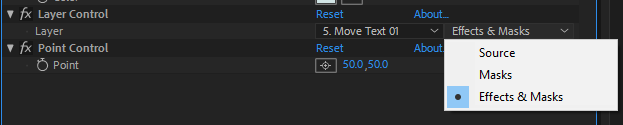

i need to get value of layer controller with script, since aftereffects 2018 layer controller has 2 drop downs, first drop down shows all layers, second drop down shows [effect, mask, effect & mask]. i could get value of first dropdown, but couldnt get value of second dropdown...
is it possible to read second dropdown value?

From everything I've seen, setting or getting the value of that dropdown is not yet script-accessible (as of AE 16.0, Oct 2018).

I don't suppose you've discovered a way to set the second dropdown since this post?
I'm applying the Compound Arithmetic effect via a script. It's fairly straight forward to set the 'Second Source' layer selection using the effect property index, but I'm stumped as to how I can change the second dropdown from 'Source' to either 'Masks' or 'Effects & Masks'.

There isn't a way, short of potentially setting up the effect with the right dropdown, saving it as a preset ffx, and applying that. Maybe.
