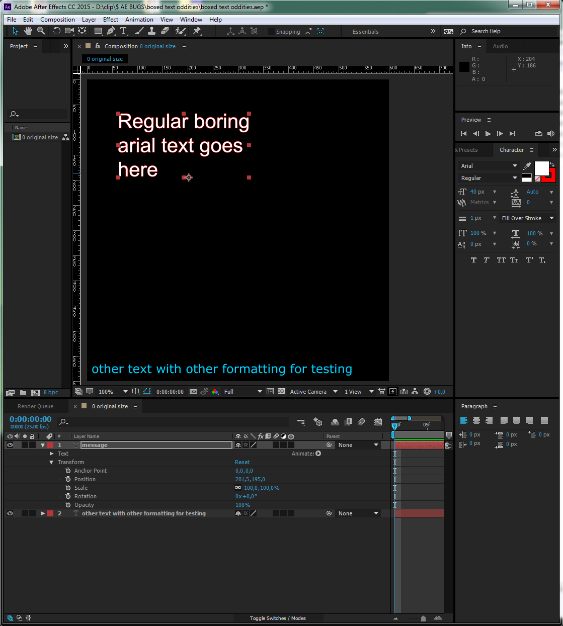

The problem with that is that if you resize the boxed text, the position and anchor stays the same, but are now "out of sync" with what you would expect them to be, i.e. the anchor is no longer at the center of the box, but at the OLD center of the box:
E.g. observe this:
Which shows the anchor in the center:

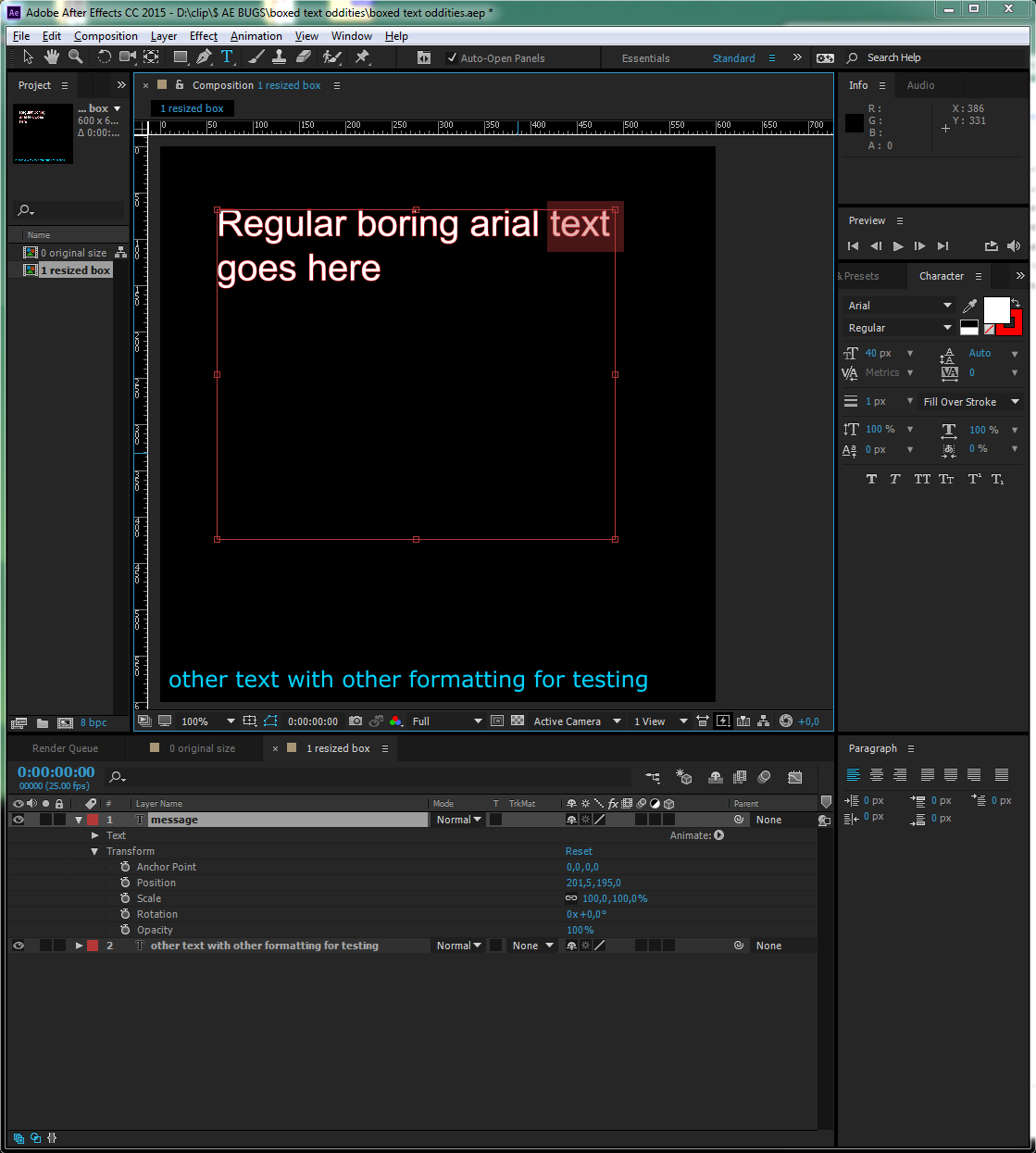

However, if you extend the text box both vertically and horizontally, you'll see that the anchor point and position stays the same, but the anchor is now not at the center any more:
So.. this is where the "magic" offset comes into place...
Again: the anchor and position is STILL the same, AND the .sourceRectAtTime() function returns THE SAME VALUES.
