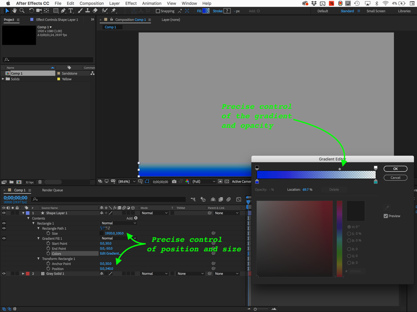

Apr 12, 2018 Apr 12, 2018
Inefficient means more steps to complete than is necessary and more rendering time. Sorry, your method is not what I would have chosen because it involves a lot more monkeying around than is necessary and frankly, will take longer to render. It was also inefficient because you did not understand how feathering works or take time to look at the results you were getting. We are just trying to help. To fix the problem you just repositioned the mask so that the feathering did not extend past the edge of the layer.
If all you needed was a feathered gradient then create a solid, set the comp panel magnification factor to about 25%, use the rectangle tool to draw a mask at the bottom of your frame about 1/2 way through the center of the faded transparency you want to create and extend it beyond the bottom of the frame a sufficient distance to allow for the feathering, press the f key to reveal the feather property, set the feather, add Gradient to your layer, adjust the start position for the gradient to match the top of the feathered edge, adjust the colors.
No scaling, no extra time calculating and rendering the scaled pixels, no other problems and done in about 2 minutes.
An even more efficient approach would be to use the rectangle tool to draw a gradient filled rectangle exactly the size you want at the bottom of the frame, press the U key twice to reveal all modified properties of the shape layer, edit the start and end color of the gradient and the opacity of the gradient and the start and end points of the linear gradient. One layer, no extra calculations, perfect numerical control over the size of the soft edge at the bottom of the frame. I did this in under a minute by simply double-clicking the rectangle tool with a gradient fill applied, pressing the U key twice to reveal all modified properties, clicking once on the Transform Rectangle > to expand the properties and tabbing through the values and entering numbers. Then I clicked on the edit gradient tool to create my transparent gradient with a lot more control. This method also imposes almost no rendering hit to your project.

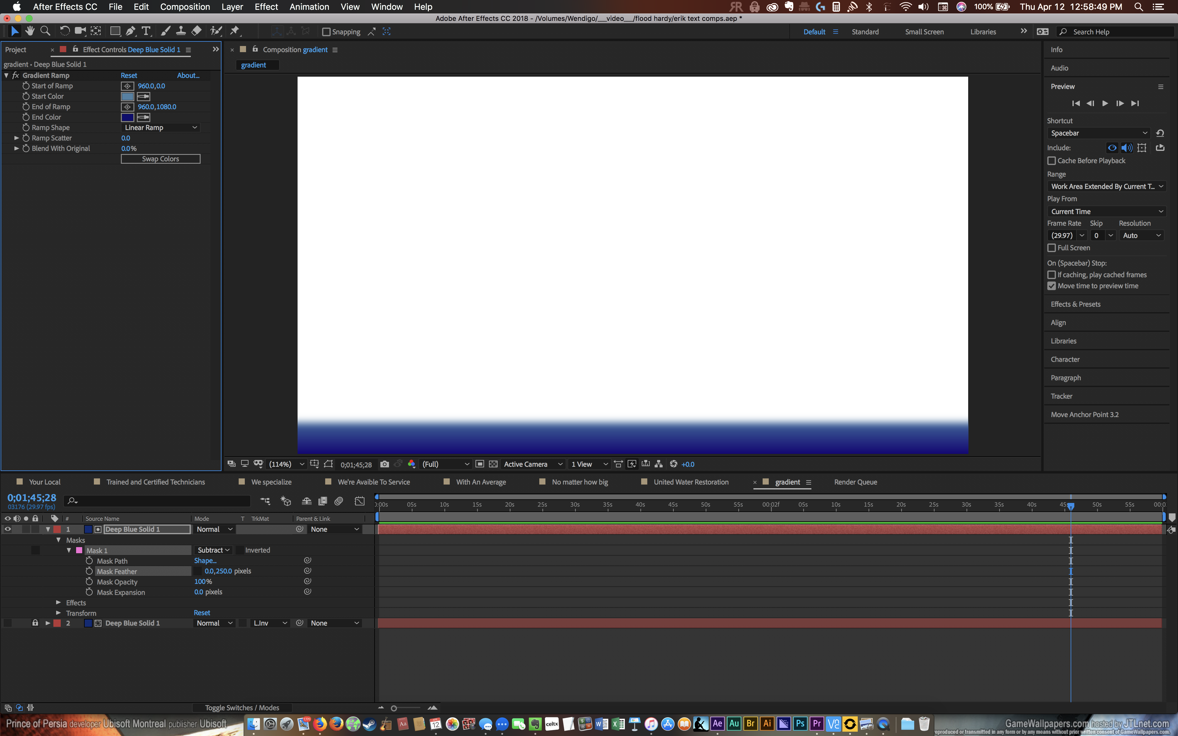

Hmmm did it wrong, but it worked... Thanks fellas! Screen Shot 2018-04-12 at 12.58.49 PM.png

If you'd look a little deeper into that layer, you'd see that it's hidden. I TRIED applying a track matte as suggested, but it didn't work. The way I did it worked just fine. I'm about to head to class, but when I get home later tonight, I'll post how I did it .
With the limited time I have now, I'll explain as much as I can. I made a solid and applied a gradient map to that solid. Then I scaled the solid down to the size I neeeded it for my project. After that I applied a mask to the top of my gradient/solid that I scaled down. I then selected subtract for the blending modes for my mask and set the mask to 300. Gave me a nice feather on the top which is exactly what I wanted.
