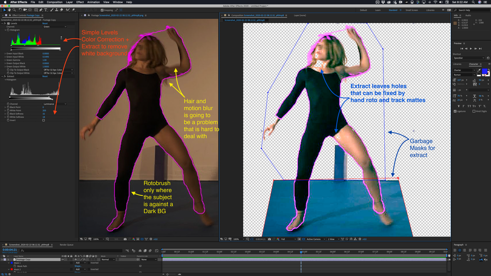

This is going to take a combination of techniques. Rotobrush is going to only work on part of the scene. The motion blur and hair are going to be very difficult to deal with. You are going to end up with a bunch of copies of your footage, a fair amount of manual rotoscoping and mask animations. Here's the basic setup to start:
The exposure and color balance is terrible. Simply matching the output of the Red, Green and Blue channels will get you close enough to use Extract to remove most of the white back wall. That is going to leave holes that you fill by adding animated shape layers that can be used as track mattes or by adding masks that can be used in the compositing options for extract. That will leave you the darker floor. Rotobrush may, and I mean may be able to help separate the dancer's legs from that background or maybe you want to leave the floor. The motion blur is going to be a problem that may require a duplicate copy of the footage with a carefully applied Rotobrush Refine edge applied to an animated mask over just the motion-blurred part of the image.
I have been doing this kind of work for about 25 years with all kinds of software and before that by hand painting masks on animation cells. If a client brought me your 5-minute clip I would quote them 40 to 50 hours to pull a good matte. If the footage was shot at a higher shutter speed to eliminate most of the motion blur, properly exposed, and a little more care had been taken with costume, lighting and removing things like the box in the background that estimate would drop to about 4 to 6  hours. If it was properly shot against a background that could be keyed we are talking about an hour.
All is not lost, but you'll probably need a couple of weeks to get the technique down and successfully remove the background.

Also @Rick_Gerard can you explain me more about "matching the output of the Red, Green and Blue channels(simple level clor correction) and the use of EXCTRACT to remove white background
