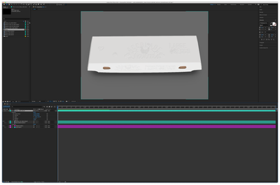

a3.pngFirst is Magenta Background (so I know when the key works)
a2.pngSecond is subject (this version has no color/graphics, but you get the idea of what I want to crop)
a1.pngThird is 'Mask' footage - basically the black is for the subject, and the Cyan is what should be 'see through'...

Not so good, actually - when I move in the timeline, the mask doesn't move with it for some reason!
May 16, 2023 May 16, 2023
Pre-composing, paying attention to rendering order, and turning collapse transformations on and off can usually solve the problems you seem to be having.
It would really help to see an uncropped screenshot of your comp with the modified properties of the problem layers showing. Press 'uu' and let us see what is going on.
Set Matte does not take into account layer transformations, so if you move a layer you want to use as a matte, you have to pre-compose it before you can use it as a set matte. Track matte may be a better option.
