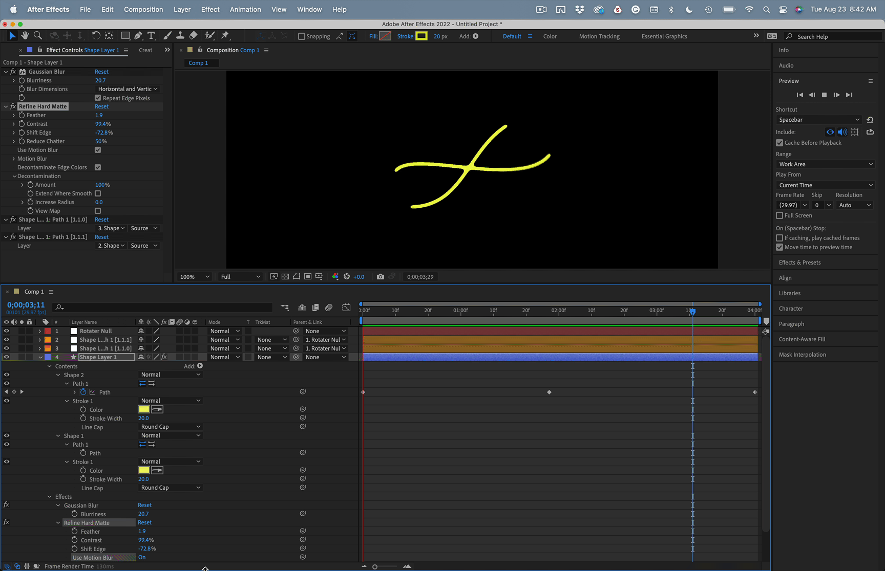

If you add Gaussian Blur to a shape, then add Refine Hard Matte, you can sharpen up the edges of the blurred intersection and simulate something like wet ink lines blending into each other. This is what I got in just a couple of minutes.
A couple of other workflows can blend shapes like liquids do when they get close, but this one should do what you want. Set the color of one line (shape) to a different color, and you'll also get color blending at the intersection.
I've attached the comp. Using the Create Nulls From Paths/Points Follow Nulls to animate the moving path.
