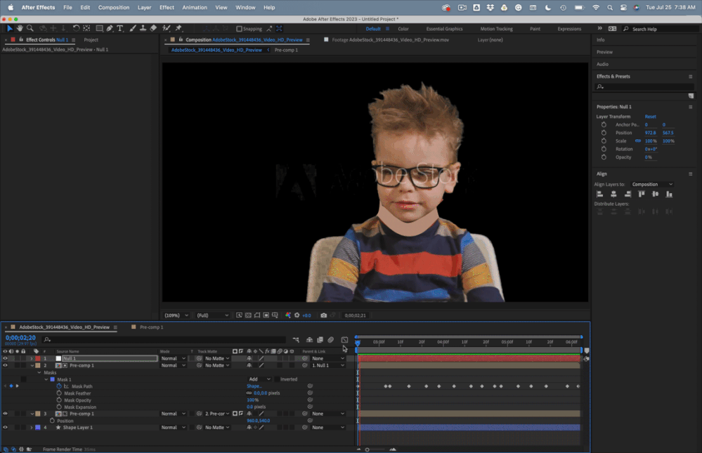

I downloaded a greenscreen shot of a kid spinning, Used Time Remapping to give me the bottom layer that I could mask, put a shape layer as a temporary neck below the body, animated a mask on the top copy of the keyed shot to give me the head, then just set a couple of keyframes to keep the head lined up. It took about 10 minutes.
This shot needs a lot more work, but it should give you an idea of the basic workflow. It only took a few mask keyframes to isolate the head. The Head layer was parented to the Null, and the position of the null was animated with only four keyframes.
