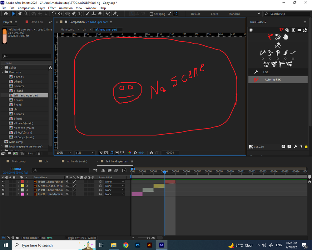

thanks i dont want to reset scene or workspace i want it to focus in the object i selectet from layer's and  ctrl + / did not work for me also to centering the workspace idk why
Community Beginner ,
Jul 07, 2022 Jul 07, 2022
see even doing the centering workspace dosenot work because some of my layer are not exacly in center of work space  i completly lost my work space and i can not find it - maybe by chance if i move my workspace i find it but there should be a way that you select a layer and then you hit something on jeyboard and it move the workspace to that object's place on scene

By workspace, do you mean Composition Frame?
I see several significant problems with your project.
First, your Composition Panel is set to 12.5% magnification. That means an object that iw 100 pixels wide will only be 12 pixels wide in the Comp Viewer.
Second, the left hand upper part Composition is only 31 X 99 pixels. At 12.5% magnification, the whole comp would be less than 4 pixels wide in the comp viewer. I can't see anything if I create a comp that size and set the Magnification to 12.5%. If I set it to Fit, the magnification is 1100%. Your comp is way too small to work with for any standard video delivery.
Third, I have no idea what the position values are for any of the layers in your active composition. The preview in the Project Panel shows what looks like an arm with a shirtsleeve. I don't see any other layers, and I can't see where different parts of the arm would fit in the tiny comp.
Fourth, Your composition panel is set to Full resolution. It is almost always best to set that to Auto.
If you change the Magnification ratio to Fit or 100%, you should be able to find your incredibly small in the Composition Panel. Figuring out where the other elements are is another problem.
I also don't know where the Gray color comes from. If you have set your Composition Background Color to Gray, you must realize that you still don't have any pixels in the background. The Gray will render black with almost all video formats because transparent = black, and Composition Background Color does not create any pixels. It is still transparent.
I am also unsure why you pre-composed the arm parts and sequenced the layers; each layer is only one frame long.
Where did you get the workflow? What size is your main composition? What size is the artboard in the Illustrator file you are using?
As far as zooming into a layer's boundaries or centering a composition view on a layer's anchor point, there is no shortcut for that. Fitting a comp to the Composition Panel using the Magnification Ratio popup or keyboard shortcut (Ctrl/Cmnd + /) should show you all layers positioned inside the composition frame at that current time. If you select the Zoom tool (z) or center the mouse pointer over the appropriate layer and scroll or push in, you should get a close-up view framed the way you like. You are not going to be able to see anything if the composition frame size is 31 X 99 if the Magnification is set to 12.5%.
You should also be aware that any comp that you send to be rendered to any delivery format like h.264 MP4 must be an even number of pixels high and wide and should conform to standard video format frame sizes for best playback performance. All lossy compression formats (anything for delivery to the public) must have blocks of at least 4 pixels to compress color. If you send a comp with an odd number of rows or columns of pixels the encoder will make up the difference and either add a black line or degrade the image.

hi the main comp size is ok i just sent you a precomp- and why it's to small and you can not see the rest of arm is because i am doing a type of riging which you seperate difftern part's of body in diffrent precomp's the you use this one frame methoud and then when you come back to you'r main comp (which is in a normal size like 1920 * 1080) you can use time remap to control and change each part of body. and wht those arm comp size is so small it's because i did crop it because i dont need to be a big comp bacause after doing what i should do , i will bring all precomps to main comp .
_________
my question was just this - if you ever worked with 3d software like maya  if you are far away from you'r stage or scene if you hit (f) it will come back to stage . or if you select  a specific part of you'r 3d model and then you hit (f) it will jump  into that part of model you selected . is there any thing like that in after effect ?

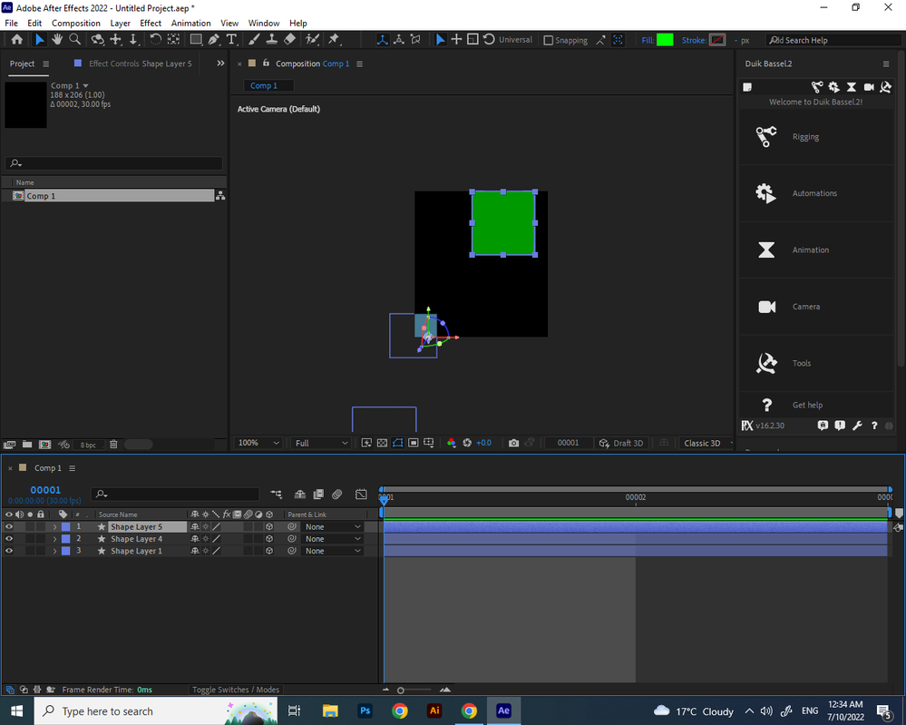

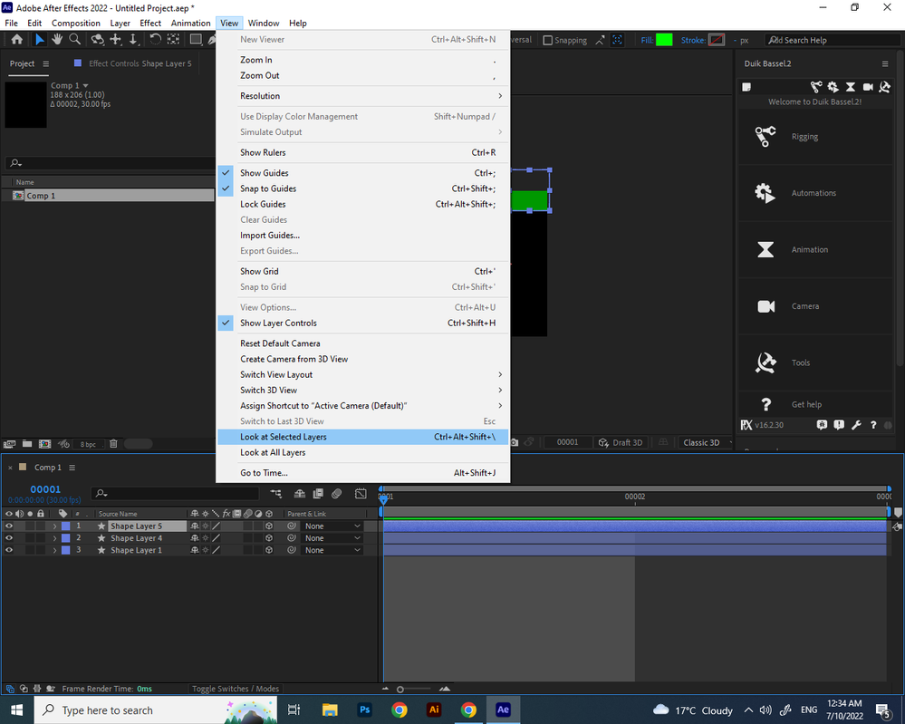

finally i found the way . we should make all layer or the layer we want (3d) then from view menue we chose look at selected layer and it will jump into that layer in workspace
