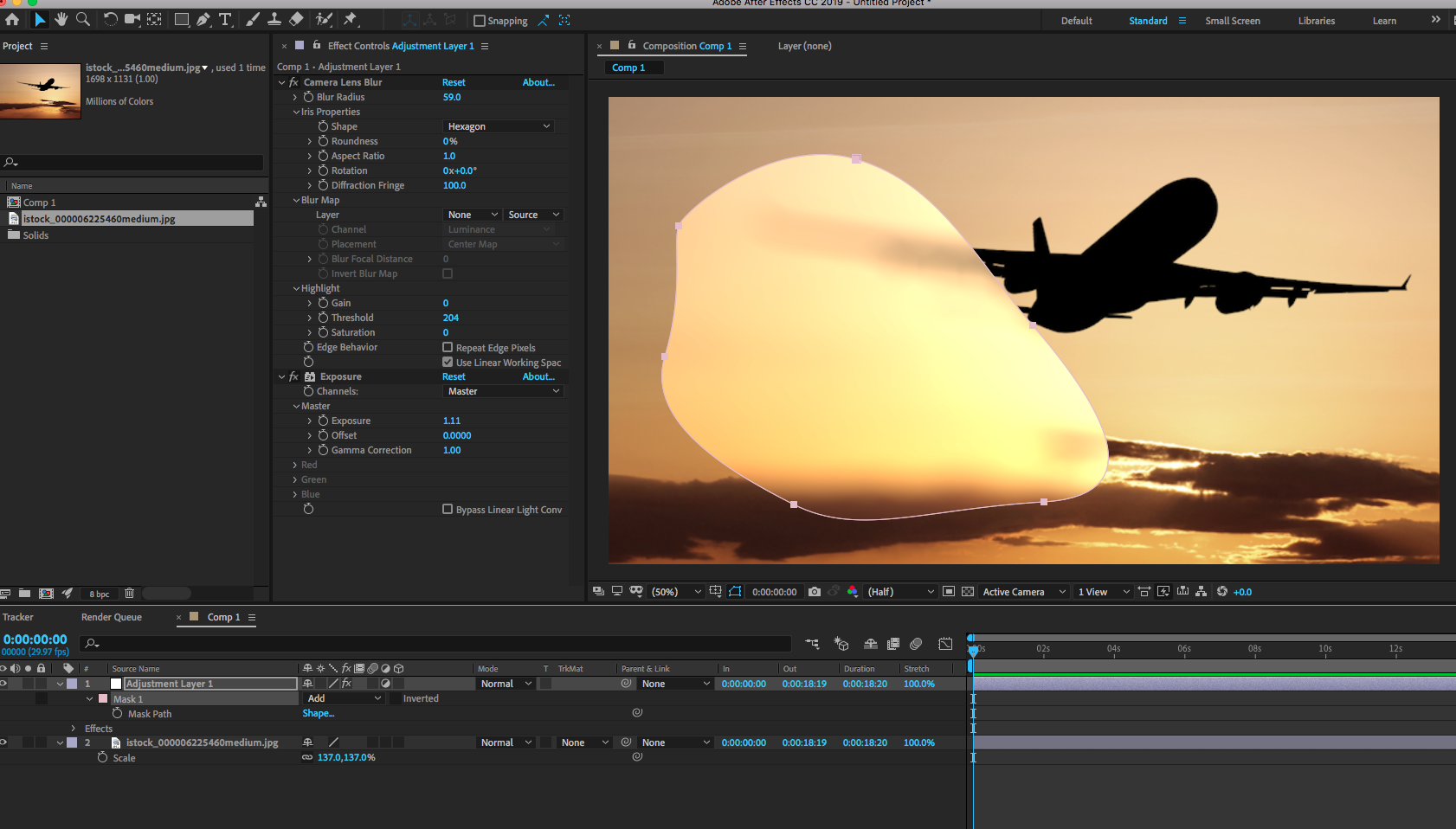

Apr 02, 2019 Apr 02, 2019
You add your effect to the adjustment layer which applies the effect to all layers underneath it. Then add a mask to the adjustment layer to only apply the effect to the masked part of the frame.
Steve
