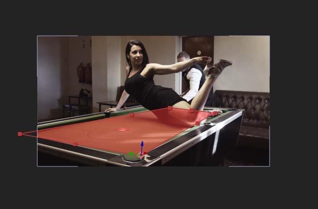

im working on a 3d camera track here , but it doesnt seem to be working out
i took the shoot using a sony A7s camera, full frame  with a  24mm lens
the 3d camera track came up with : 36mm sensor and 44.53mm lense , i left a beer matt on the table as a guide, and i create a solid from that, and oriented the solid so that it fitted perfectly over the beermat.  however when i extend the solid out the full size of the table, it appears as though the perspective is different from the footage.  it looks like a wider lense or something.  however when i attempt to change the focal length or focal distance to rectify this i loose the track position of my solid , as in, it doesnt stay stuck to the table anymore.
how can i rectify this?
369
May 07, 2018 May 07, 2018
The first thing you need to do is correct for lens distortion. AE's lens is perfect, there isn't a 24 MM lens that costs under about 15K that is distortion free. It's best to set up a test shot filming a grid that is perfectly square to the camera then figure out what correction you need. The edges will be the worst. It is really too bad that the Lightroom lens profiles cannot be applied to video. They are amazingly good.
Once you remove the distortion either render a suitable DI or pre-compose and run camera tracker again. Make sure that you do detailed analysis, set an origin and ground plane, remove any tracker points stuck to anything that is moving in the shot and run your test again. Adding the Effects>Generate>Grid effect to the solid will really help you position the reference solid perfectly. It's very easy to include track points that are not on the plane you are referencing and this will foul up your placement. That plain green surface probably does not have many track points on it so you will probably have to use the edges of the table and then move the placed solid down a little bit to get it to perfectly match the shot.
It is really easy to get frustrated when you don't perfectly pick the track points you use to define the plane and even more difficult if the plane you pick is not the one you want to modify. It is also impossible to perfectly match the edges of the frame unless you remove lens distortion.
