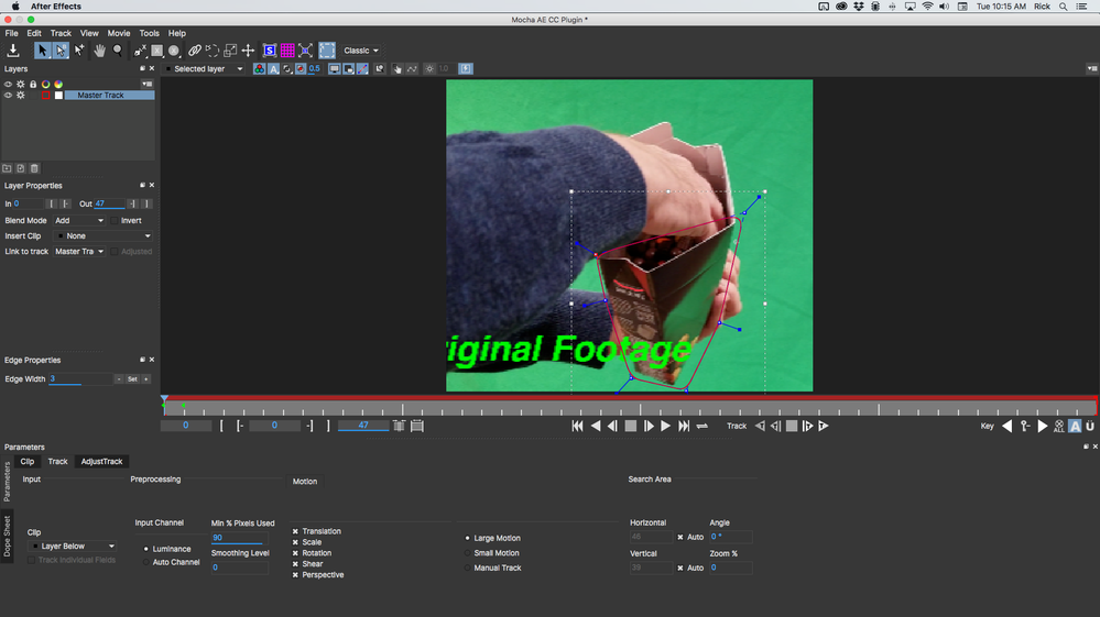

EDIT: Just saw your screenshots. I would motion track the reflective surface of the bag in Mocha to create a matte, then color correct a copy of the footage and set up a track matte. There's not enough green spill on the skin or sweater to cause any problems. I'll show you a couple of screenshots a little later today.
Something like this:
There are lot's of approaches, but this one works pretty well. The way to make the shot work is to eliminate the reflections on the bag by creating a mask and the easiest way to do that is to track the bag, then tie a matte to the tracked bag in Mocha. It would take me about 15 or 20 minutes max to do that in just about any clip. Once you have the reflections eliminated then it's just a matter of using the mask generated by mocha to control the area you are going to color correct. I just desaturated the green to keep the reflection and turn it approximately the color of the bg image. The copy of the footage uses Hue Saturation to remove the saturation from the bag so the green won't effect the key. You can see all of my settings. I could also have done it all on one layer.
I hope this helps. Pulling a really good key with marginal footage is pretty easy if you work on the real problem areas before you try and pull the key.
