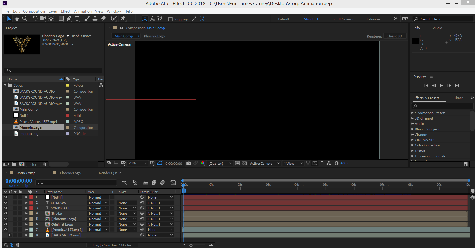

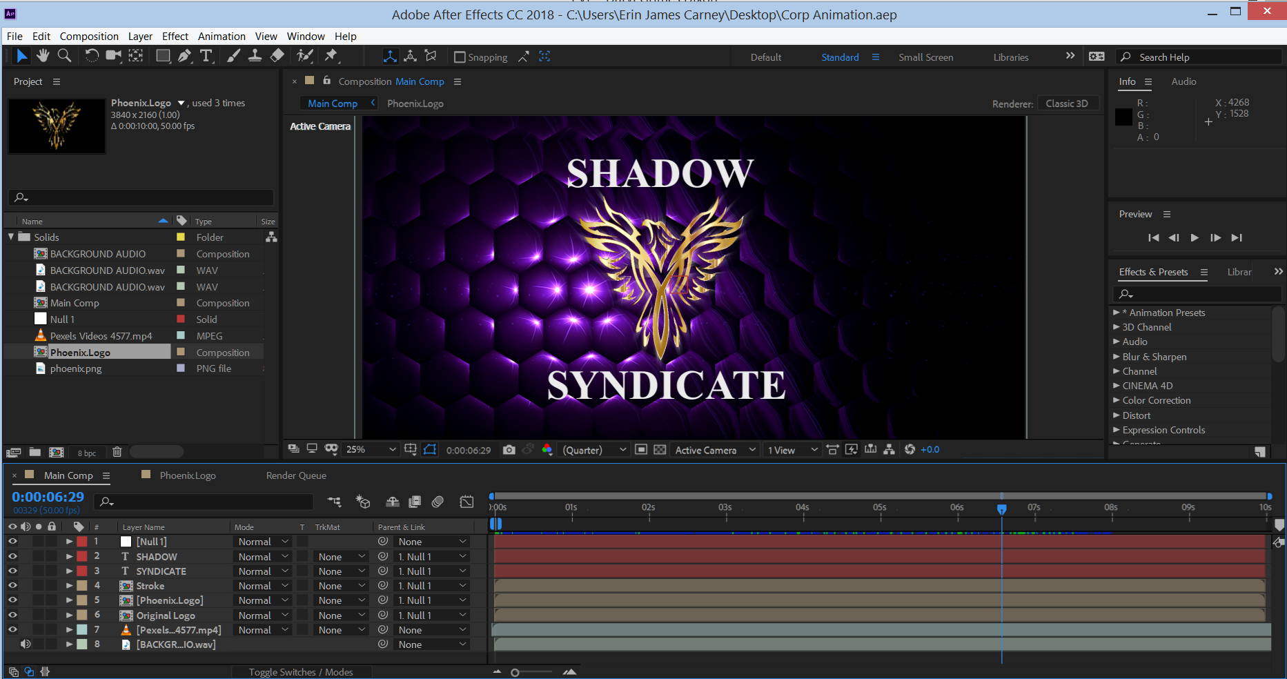

I don't know where the problem is originating.
When I try to render it renders in a second or two and is nothing.
Here are some images of my Composite.
If I preview it, it looks perfect, but once I try to render it, nothing happens...
Oct 17, 2018 Oct 17, 2018
You have the work area set to only a few frames. Read the documentation. The work area is a basic part of the UI that you should understand.
Check the Render Settings. You have options there to render just the work area, set your own custom in and out points or render the entire composition. Again, spend some time reading the documentation.
If you are using the Adobe Media Encoder to render you also have the option there to set custom time, render the entire comp or use the work area. Again, please spend just a moment reading the documentation.
