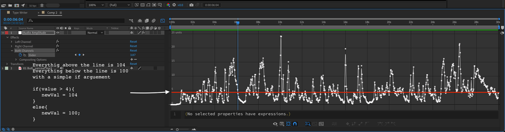

I think you have more problems than just the formatting issue. Audio levels typically run from 0 to 30. Four is a very low threshold for most audio and the change from 100 to 104 isn't much so you are not going to get much of a reaction.
Another problem is that a simple if statement is on or off. Your scale would either be 100% or 104%, which is hardly enough of a change to give you much of a change in size unless you just want a small vibration that rattles only when the sound level dips below a very low background noise level.
I would consider using an interpolation method. The first step is to open the Audio Levels Both Channels Slider in the Graph editor set to display a value graph, then look at the range and figure where you want the switch to take place. Then you build your interpolation method.
This tutorial I just released explains it all pretty well.
