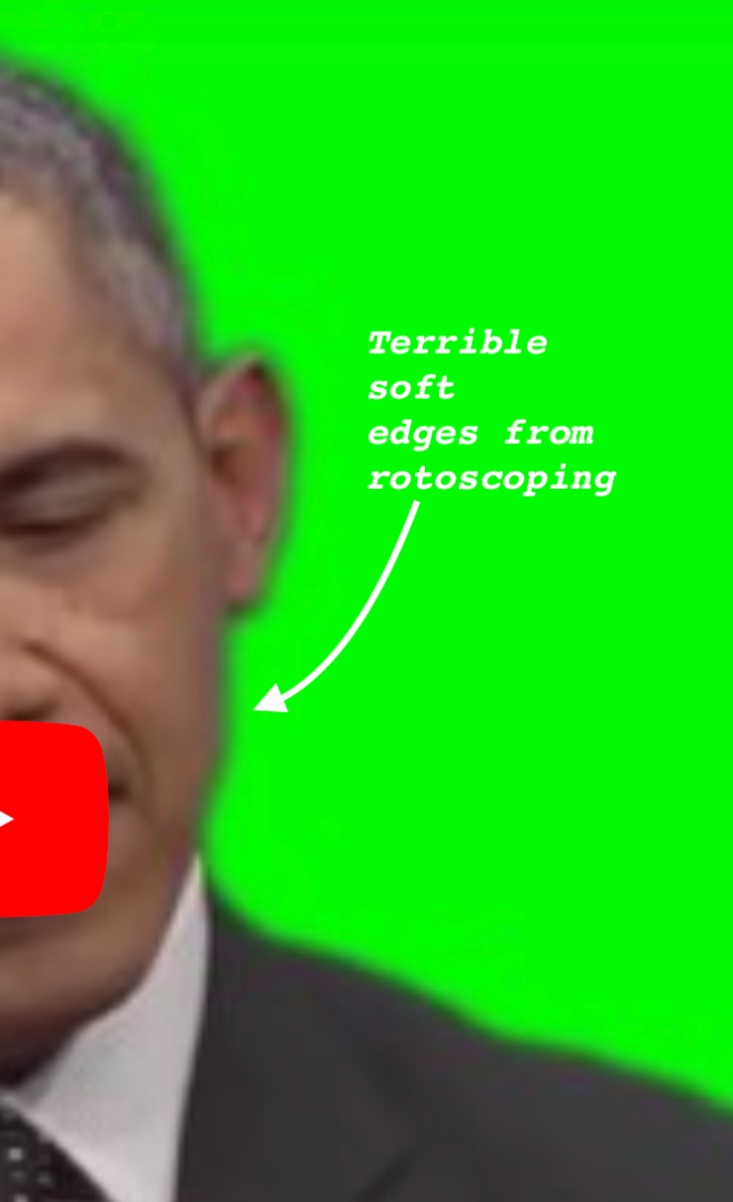

You still don't get it. The footage of Obama was rotoscoped, and not very well. The background was removed so it can be replaced. The person that replaced the background with green wasted his time and yours. Here's why:
See those terrible soft edges. It will be impossible to pull a decent key from that footage. The background was already removed. The only reason that green background was put in there was to try and make it easier for other folks to replace the background. What they should have done was render a black and white alpha only copy of the footage that could be used as a track matte to remove the background from the original footage. You would have none of the soft edges, Removing the background would have been a perfect single-click solution with any NLE that can do keying. If the person that did that work wanted to put in another background he could have done it when the roto was done. You can't post a video on YouTube that has transparency (alpha channel) so this is an amateur's solution to a problem that doesn't really exist.
