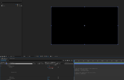

This expression applied to the Size parameter of a Rectangle Path of a Shape Layer will set the X and Y values to the Compsition width and height.
// Get the width and height of the composition
compWidth = thisComp.width; compHeight = thisComp.height;
// Return the composition size as an array
[compWidth, compHeight]

Hi Airweb and Warren. Thank you both very much for your help. Sorry, I forgot to mention that my reason for placing the Sea layer outside of my Europe comp has to do with how it affects layers and masking. If I place the Sea in my Europe comp, it intereferes with my layers. I took a pdf map of Europe from Wikipedia and removed the map's blue sea background with AE's Extract FX. This is so that I can draw layers over countries and not have to worry about spilling my layers over the coastlines. But if I then introduce a Sea layer as a background, it kills the Extract effect on the land layer. So instead I add my Sea layer in the 3D comp. In the example below, you can see my Sea layer enabled and then disabled in the original comp.
