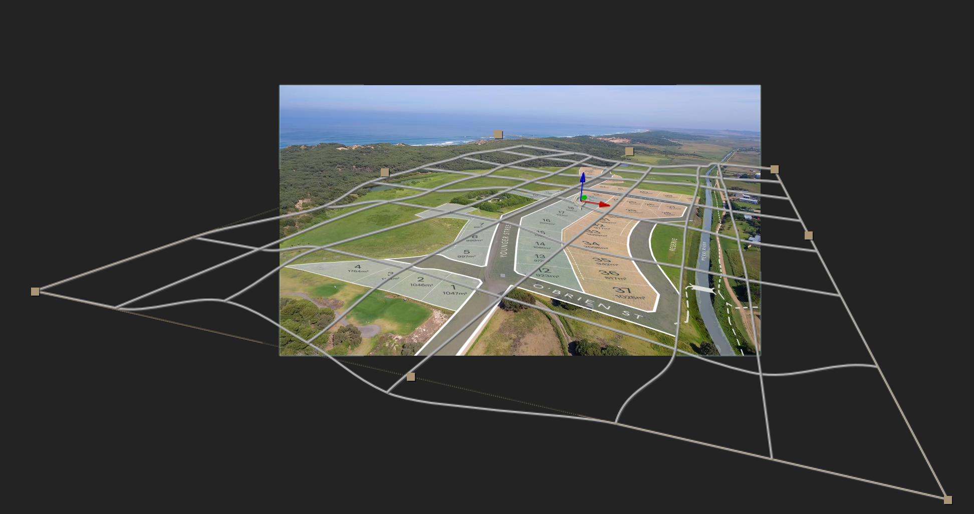

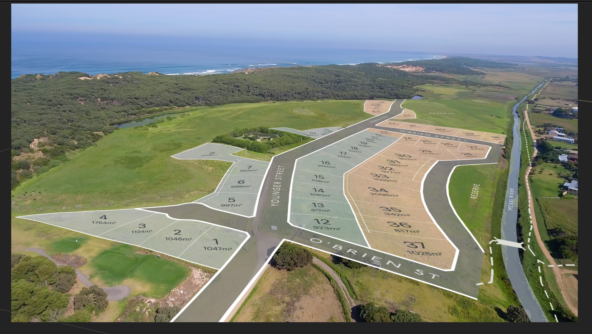

I am currently working on an animation where I lay over a 2D development site over ariel image. I have successfully done this in the past with 'Mesh Warp' (as you can see in the images I have attached below.
The issue I am having is we are getting a lot of request for these kinds of jobs and Mesh Warp takes a lot of time to line up and make work correctly. Is there any better ways do line up multiple points on a 2D image, with points you assign on an ariel Image?
Cheers, Wes

If the folks that did the illustration used a cad program and they have topographic data from a server to create a grayscale topographic map of the area then you are home free if you are willing to buy or have Forge Freeform Pro. If the illustration is topographically correct then all you have to do is to set an origin and ground plane with you camera track that is located at the center point of the graphic, then apply Forge Freeform to the graphic and use the grayscale topographic map for a displacement map for the drawing. I've done this several times and it works great.
If you have access to the drone or the drone pilot another option would be for the pilot to use something like Drone Deploy to create a 3D model of the area. You can then use the illustration as a texture on the 3D model and use that textured model in your project. I've also done this a few times. The trick is to do the camera track, set an origin and ground plane at a recognizable point on the ground, and then add a solid and a camera to the scene using Camera Tracking. When you have done that you export the comp as a C4D project and then just line up the 3D model with the footage. It's pretty easy to do for most jobs, but on occasion you'll have to add another solid through camera tracking to help you get things lined up.
