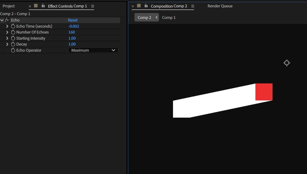

You should be able to get Echo down to a smooth/continuous line by setting the Echo Time low enough and Number of Echoes high enough.
I'd recommend starting by setting Echo Time to 1/ your comp's frame rate. (So if you're working at 24fps, type in 1/24 - and don't forget to set this to a negative value, or else it will be in front of your footage). Start dividing this number by 2 and increasing the Number of Echos. You should get there eventually!
In this example, the Echo Time is actually set at -0.0016.
(The red square is a second layer, created for visibility of this object in the current frame.)
You may also want to experiment with having a higher frame rate on your source footage (if possible), as that will require fewer echoes to be created for a smooth trail.
