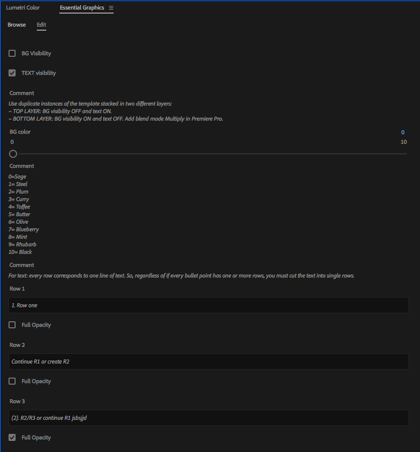

I used your approach, however, I have a slightly different setup, since every text row (i.e. bullet point) needs to have the option to lower the opacity to 70%, after it has "been presented" and it´s "time" to show the next point. But it was for sure a good suggestion! This is my setup:
