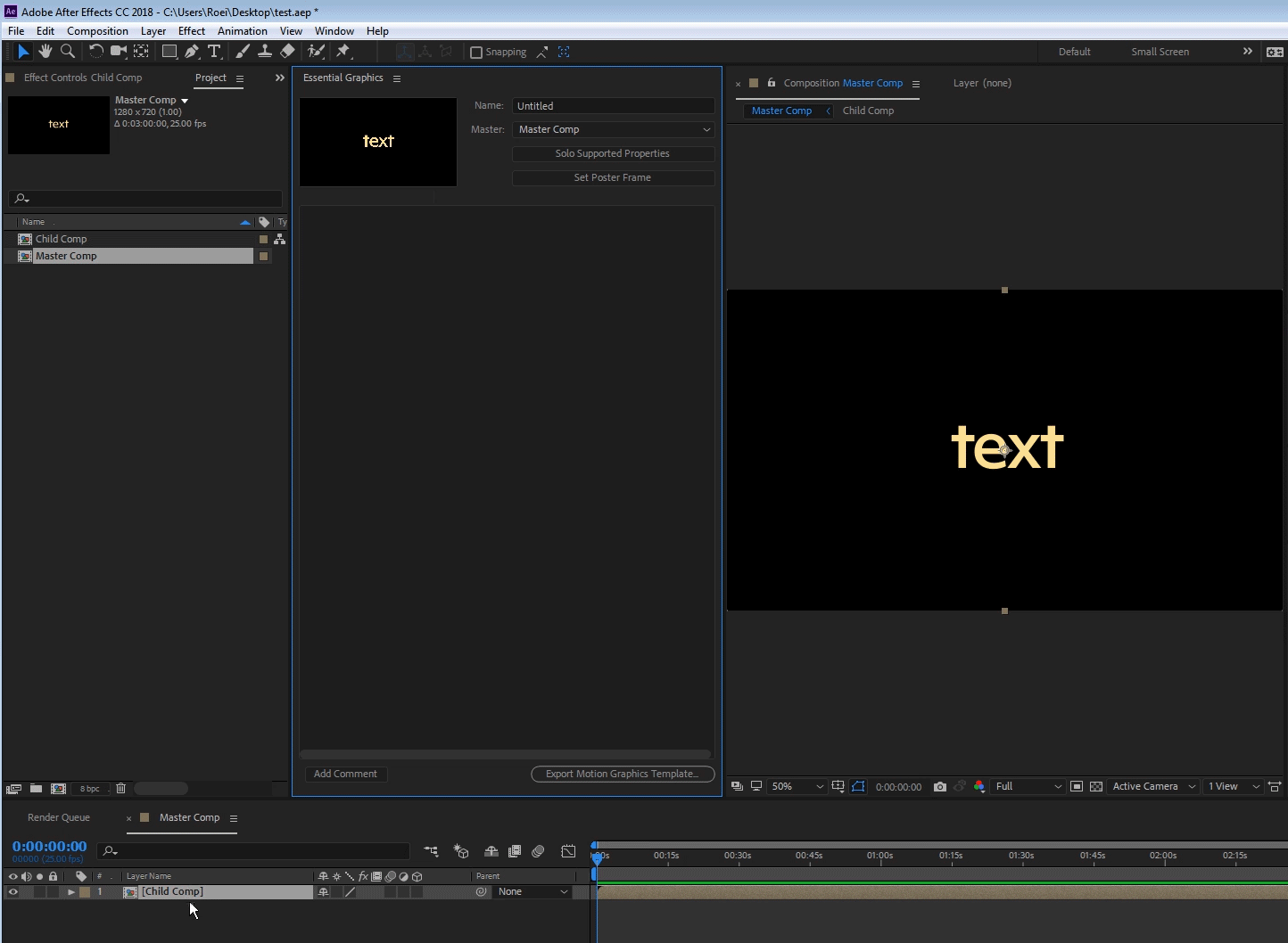

I have done a few text boxes for a project that autoresize the bg plate after the number of letters used (and more...) But I like precompose the after effect files and add some animation to the plates. But motion graphic templates seams to not work when using precomps. Is this correct?
kinda.
if you have properties that you already linked in the EGP and you precomp the layer that has the properties - you will lose the properties in the EGP and would have to relink again. if you first precomp the layer, then link the properties from within the precomp to the EGP - it will work.

Im using a layer to hide the precomp behind for the reveal. I like to have a slider for that layers y transformation. But after effect tells me this is not supported! or Property is unrelated to "The graphic precomp" and will not affect rendering.
The reason I like to be able to change the mask layers y axis is so that the reveal will be at the exakt place even if I skip a few lines

you will get "Property is unrelated" if you try to drag a property to the EGP that is not related to the comp selected in the EGP "Master" (child or parent comp).
make sure that the "Master" in the EGP specifies the parent comp or any related comp.
