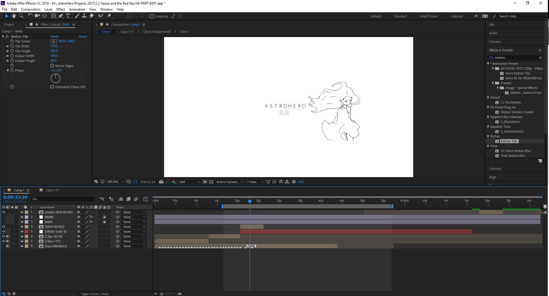

Been wracking my head since midnight trying to get this thing to work.
I'll cut to the chase, because I have no other idea why it won't render.
____________________________________________________________________________________________________
Keypoints:
-Disabling Motion Tile makes the render possible, enabling it results in the "Failed" status in Adobe Media Encoder.
-I can confirm Motion Tile is the problem, since I disabled all other effects one by one (Twixtor Pro, Gaussian Blur) and rendered each time after disabling each effect.
-Moving the Motion Tile effect to the bottom of the "Effect Controls" list (see examples below) allows the render to work, but my position keyframes and scales cause black edges to appear.

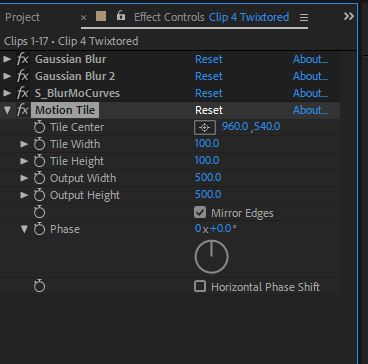

Putting Motion Tile on top = Render Fails

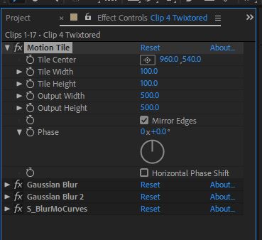

Putting Motion Tile at the bottom = Render Works (but black edges appear on the sides - EXAMPLE BELOW)
Example of the black edges:

SPECS:
Using After Effects CC 2018
CPU: Ryzen 7 1700 8 Core
GPU: Asus Geforce GTX 970 Turbo Edition
RAM: 16 GB of Team T-Force Night Hawk RAM - rated @3200mhz speed but running at 2133mhz instead
Storage: 500GB SSD, 1TB HDD, 2 External Hard Drives (After Effects is installed on the 500GB SSD, and the project file is on the 1TB HDD).
