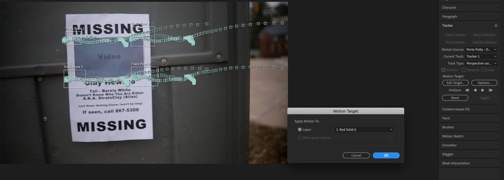

I'm using Motion Tracker to track a gray box that moves around the frame and then replace it with a red solid that I have set as the target of the tracker.
After I apply the tracking to the target, the red box jumps to the location of the last tracking point and does not move with the tracking at all.
note: I can provide an image of this if necessary.

From your screenshot, I think that you are having problems with Corner Pin tracking, not Motion Tracking. It appears that you have generated some keyframes that should be available in the Porta Potty layer. The screenshot is cropped so we have no idea about what is going on in the rest of the comp so I'll have to guess.
If the position of the target layer does not match the position of the tracked layer then the tracked layer has been moved or scaled in the comp. All motion tracking uses the Layer Panel and the Layer Panel does not show position or scale properties.
If there is no motion in the target layer then the keyframes for Track Point 1 through Track Point 4 added to the Porta Potty layer were not applied to the Target layer as Corner Pin keyframes. This can easily be checked by selecting the target layer in the comp panel and pressing U to reveal the keyframes. You should see keyframes for Position as well as Corner Pin.
If the size of the target layer is wrong then the layer size does not match the size of the footage.
There are no reported bugs in the current release of the available versions of After Effects so I suspect that this is nothing more than user error. If you can not figure it out then we need screenshots showing us the keyframes that have been generated by your workflow. Cropped screenshots and layers that do now show the modified properties (keyframes) are pretty useless in diagnosing problems.

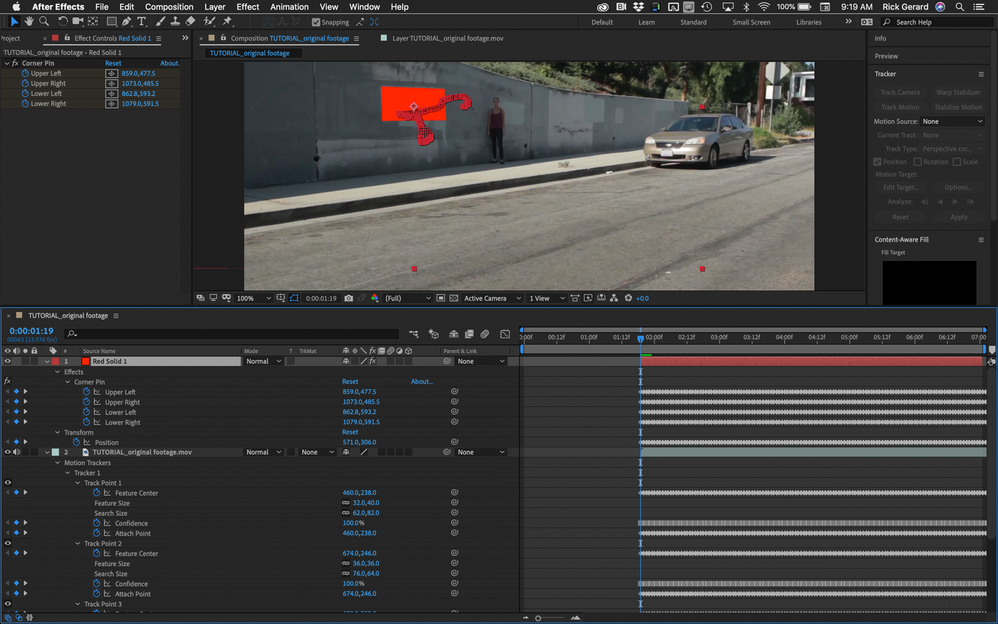

Look at the keyframes. If they are not lined up then undo the apply, set the Current Time Indicator of to the in point of the footage and apply again.
I still don't know what is going on because you cropped your screenshot. The screenshot should look like this:
