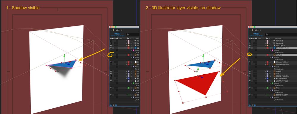

We might be having a similar problem here.
In out case an ADOBE ILLUSTRATOR LAYER (tldr) was causing the problem.
We created another solid, which would cast shadows if said Illustrator 3d layer was not visible and in between the light and shadow catcher.
If the Illustrator layer was visible or inbetween in the layer stack; no shadows.
Said layer has a Fill Effect and a Mask, but does not cast shadows when these things are deactivated.
Seems like a BUG to me.
Still twiddling with things to figure out what the issue might be and how to fix it, but I'll most likely parent a solid with the same shape of the illustrator layer to cast the shadow.
