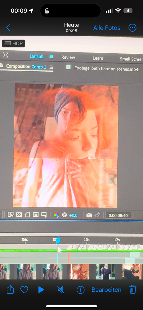

Hello, i'm having a problem where during my preview the clips overlap. This doesnt come out during the final render but its really bothering me because i want to know what it looks like without the glitch. I'm using AE 2021. IMG_4905.png

The likely causes are that this is a blended frame due to long-GOP source footage or a pre-existing cut in interlaced source footage that has not had the 3:2 pulldown removed (or has it removed at the wrong cadence).
If you select the source footage in the Project panel and take a screenshot of the Poster Preview at the top where it shows a thumbnail, the filename, the frame rate, and the duration, that will be helpful.
If it's a blended frame due to long-GOP source footage, you could transcode the source footage to ProRes 422 LT outside of After Effects, maybe even with After Effects, and then use File > Replace Footage to swap out the current file for the new one.
If it's a pre-existing cut in interlaced source footage that has not had the 3:2 pulldown removed. you can go into the Interpret Footage dialog box and remove the 3:2 pulldown.  There are five cadence options for whole frames (W) and split frames (S), so you may have to try more than once while checking the source footage at multiple pre-existing edit points.  Also, if working in a Composition that's running at 29.97 frames per second, you'll have to change the Comp frame rate to 23.976.

Here's a screenshot. I'm gonna try this and come back thank you.

None of this worked....but i appreciate the help. I think i just need a new laptop.

It looks like an issue with long-GOP source footage.
Duplicate the MP4 layer and hide the Video of the original and hide the audio of the duplicate.
Select the duplicate Layer and choose Layer > Time > Enable Time Remapping.
Go to one frame before the glitch and add a Time Remapping keyframe and then one frame after the glitch and add another  Time Remapping keyframe.
Then select just the keyframe before the glitch and choose Animation > Toggle Hold Keyframe.

So i'm just gonna have to do this with all my projects now? Because I've made edits with this footage before but the problem only started last week after i rebooted my laptop. This will make me lose so much time considering i always cut over 20 clips for my edits. And it doesnt only happen with this footage but with every new project i start.
I also have an adjustment layer with the S_Flicker (Sapphire Plug-in) effect on it and that flicker is also glitching, but you can't time remap adjustment layers.  So i'm confused about that.
I am certain my footage is not the problem. Here i made a new project with just solid layers i made inside after effects and i put the flicker that i normally put on all my projects. Same problem occurs.
I do really appreciate the help! i think my laptop may have just given up on me.
