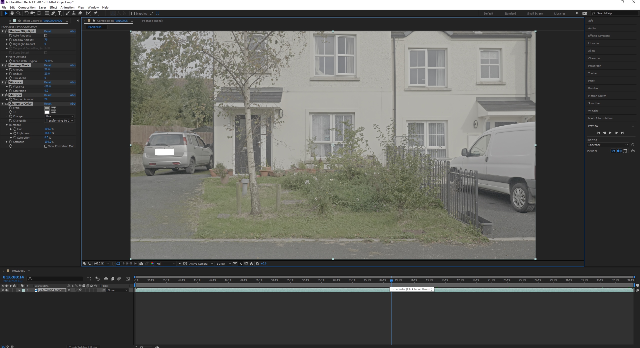

I ma not sure what happened yesterday, but it seems the videos are working now and import fine in to AE. I think the one video I was trying to import was corrupted as when I tried to play it back on the camera, it played for a few seconds and then I got an error. I tried another video and it imported correctly with no issues. However, I am getting another issue.
Even though the video imported correctly, I applied my effect settings I normally use with my V-Log L videos and tried to export it the same way I always have with the 4K 10-bit 4:2:2 150Mbps GH5 files to DNxHR 4K and it started encoding and got a little bit done then the video encoder showed the preview of the encoding video as green, so I stopped it and when I saw this and played back the video that had been encoded and it to showed the green screen on part of it.
Here is what the vieo looks like in AE:

Sep 30, 2017 Sep 30, 2017
OK, I found out that the videos I was trying to edit, had corrupted, and just exported another one I took yesterday in ALL-I 400Mbps and it exported correctly with no issues, so I don't think the problem was AE, but was my videos.
