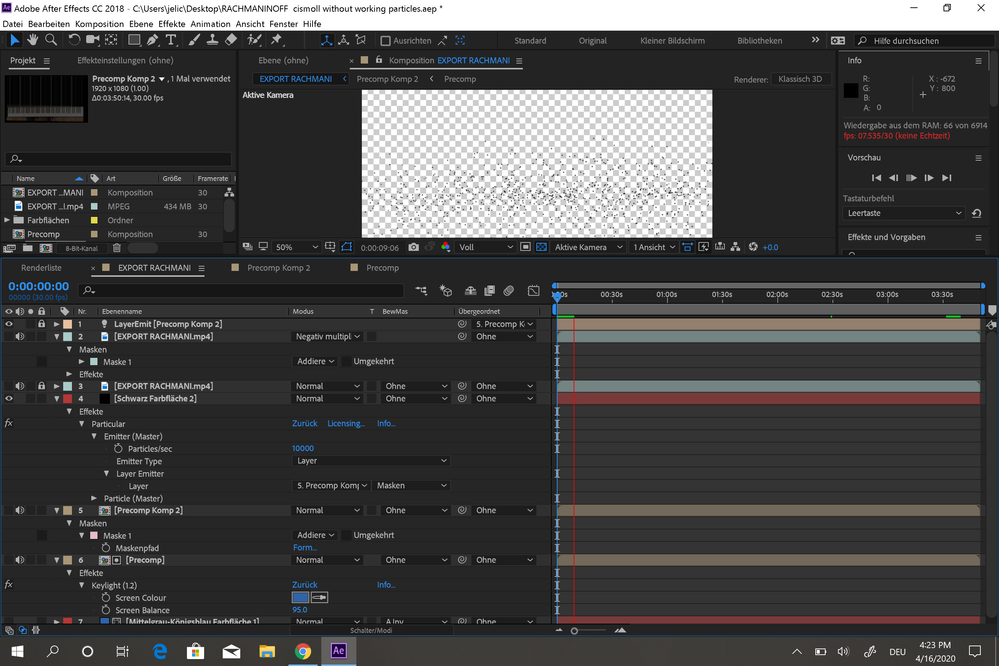

Hello!
I know this has been asked already but I am really struggling to make it work. I want to add particles to my synthesia video. Preferably they would emit when the blue synthesia tiles reach the the piano keys. https://www.youtube.com/watch?v=LSwXh1Y5thY
I tried different approaches, the first one was suggested by Rick_Gerard in this thread: https://community.adobe.com/t5/after-effects/particles-to-start-when-mask-hits/td-p/10168387?page=1
I tried to implement it but I'm not that well versed with AE.

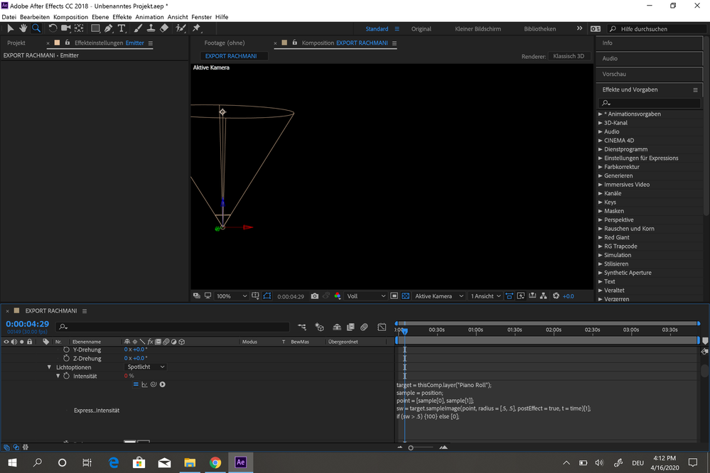

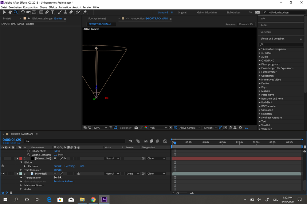

Hey Rick,
Thanks so much for answering, it really helped a lot. It seems like I got the emission of the particles to work. They start when the tile hits the piano Keyboard. I found a sweet spot for the spotlight where it works, however when I pull the spotlight down to the keyboard it stops emitting particles.

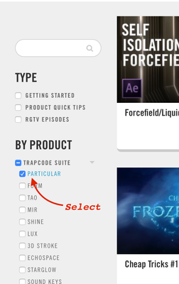

Particular is a difficult plugin to understand until you have to spend a lot of time on the RedGiant site looking at the tutorials. You can make particles do just about anything you want, you just need to spend a couple of hours at the RG site looking at tutorials for Particular. Just do a search or spin down the selector and choose Particular.

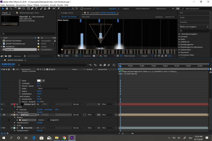

Okay will do, Thanks a lot. Do you know how I can fix the spotlight problem? Is the part that samples the colours too small? It only works in that specific spot but doesn't spawn any particles if I pull it down to the keyboard.

Your expression is sampling the blue channel.  The very first thing you should do when an expression is not working is to turn the expression off and see what that does. Turning the expression off for the Intensity of the light should return the value to 100 and start the stream of particles. If setting the Spotlight Intensity to 100 does not start the stream of particles then the emitter is not properly set up in Particular.
I suspect that the larger blue bars are the result of an effect and they may not be on the same layer as the Piano Roll. The layer could also have its position changed.
A few minutes with the User Guide will help you understand how the UI works and the section on expressions will help you understand what expressions are really doing. I am taking a mental health break from an extremely tedious project that is requiring hundreds of adjustments in several frames so I'll explain the expression to you and maybe that will help. I simplified the expression and set it to sample blue:

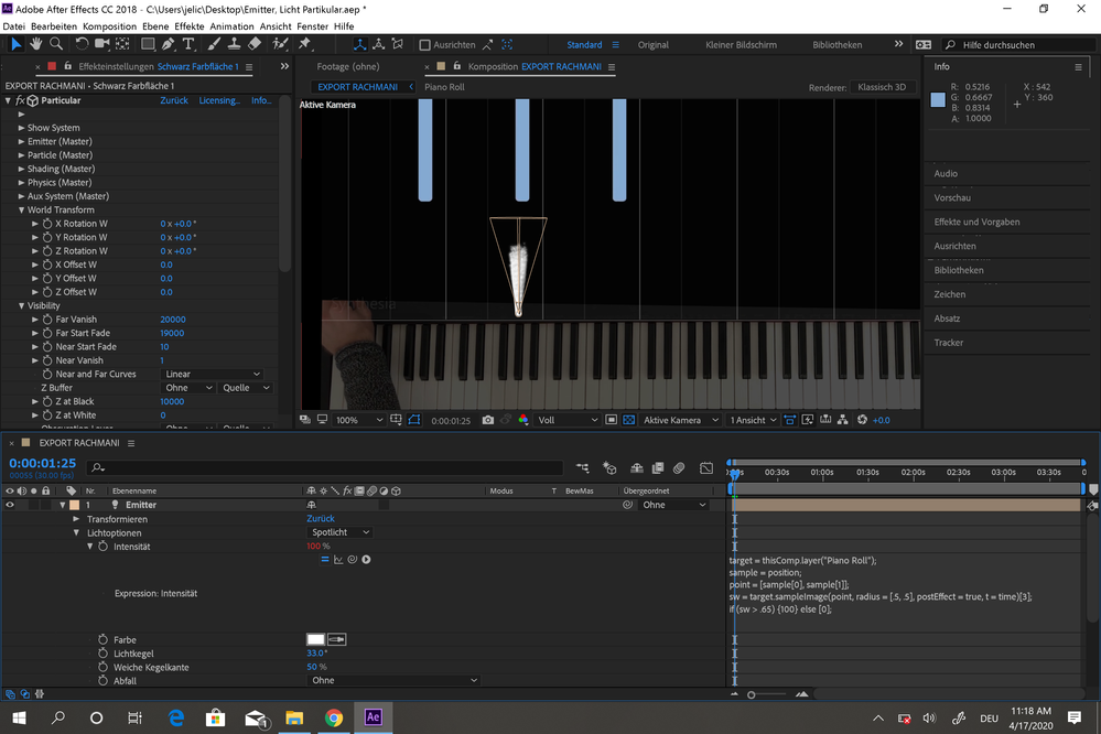

Hey Rick, I set it to [3] with a sensitivity of 0.65 since the darker blue colour has a value of .64. But it starts generating particles straight away, without it ever getting a sample. Even when it's on the black background (B value is at .01 there)  it is generating particles and it says intensity 100%

You have set the color sample to the alpha channel. 0 is red, 1is green, 2 is blue, 3 is alpha. Alpha will always be white or 1.000 unless there is some transparency in the comp. That is the easiest explanation of the intensity being set to 100.
I would not set the threshold so close to the blue value. If the sampled value using the Info Panel is .64 and you set the threshold to .65 then the value never gets to 65 to make the change in values. Your light would always be off. A value of .5 or even .4 would do just fine. The threshold just needs to be higher than the Blue value of the background layer but lower than the average color of the blue line.

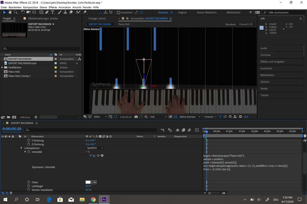

Okay, I did everything you said but even though it's on [2] now and the colour value is way higher than the asked value it still doesn't spawn particles or only spawns them when I move the spotlight away to a different spot, weird.

If the spotlight intensity changes to 100 when it is not over a blue line then the Position, Ancor Point or Scale of the Piano Roll layer has been changed. Select the Piano Roll layer and press the 'u' key twice to reveal all modified properties. If Position, Scale, or Anchor Point show then you need to make sure the layer Piano Roll layer is selected and Pre-compose moving all attributes to the new comp. The position errors will go away.  I've explained this at least twice in this thread.
